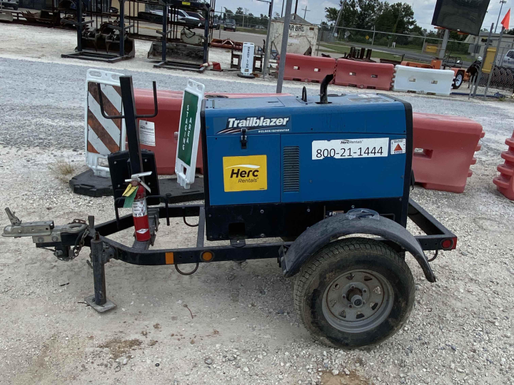

Binderdan Posted May 12 Posted May 12 I'm looking to add an engine driven welder to my service truck. Nothing against Lincolns but I like Millers, and my truck already has a cutout shaped for a Miller Bobcat in the front cabinet. A new Miller Bobcat 265 with jump start option is over $10K, and a Trailblazer is over $12.5K. Hard to justify no more than it would get used. I started looking at used ones to find most on marketplace or at auction were beat to death, and still commanding pretty good money. However I started looking at used rental units. These are a little older 2017/2018 production machines but actually seem fair priced compared to most I see for sale, and are known to be functional. The Bobcats are usually model 250, with Kohler engines on LP and sell for $2,500 to $3,500, and the Trailblazers are 325D with Kubota diesel engines ($20K+ new!) sell for $5,000 to $7,000. Does anyone have any opinions on what the life expectancy is for these machines? The ones for sale vary from 500 hours to over 5,000 hours, and built around 2018. Does anyone know if the Bobcat 250 LP ones can be easily converted to gasoline? I imagine it isn't worth the effort, but I don't have a lot of room to be adding an LP tank on the truck. Quote

Binderdan Posted May 13 Author Posted May 13 Thanks guys! The ones I'm looking at are from Herc Rentals. They seem to be offered less expensive than United Rentals and others advertise them. Sunbelt sends them to auction. Herc Rentals also offers financing on used equipment if I was to need it. Every time I find a low hour one pop up its usually far away or I can't get it fast enough. Mader656's suggestion on the Hobart isn't a bad idea no more than it would be used, and its priced below $5K new. Since Hobart is Miller's budget line now I think the machine has the same profile as the Bobcat. M35A2 thanks for confirming on the propane conversion, I suspected it wasn't feasible. I really like the idea of having the Kubota diesel. They are great engines, and I could potentially plumb it into the truck fuel tank. I did check the mounting footprint for the 325D and it just barely fits where I need to mount it. They come trailer mounted but I will mount it on my truck with the control panel inside the cabinet. Sounds like I shouldn't be scared of a couple thousand hour machine. Only complaint I have heard about Millers is circuit board failures and poor parts support on electronics. My usage would be pretty minimal, mostly power generation on occasions, and rare occasions welding. Has really only been two situations where I really needed one so far. But I like to be prepared. I just really don't want to spend a bunch of money on something at the end of its life expectancy. 1 Quote
