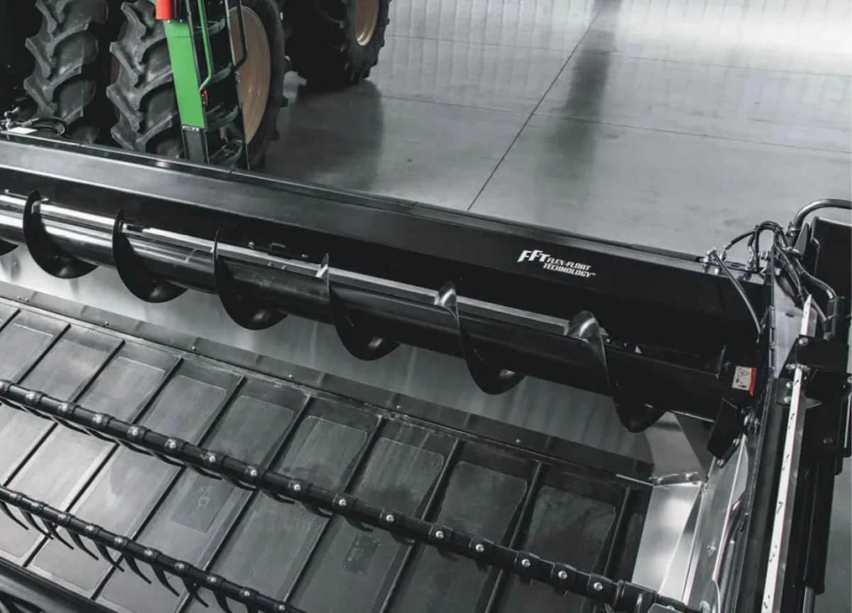

SDman Posted Monday at 02:28 AM Posted Monday at 02:28 AM They offer pea augers for draper heads for dealing with tall, bushy crops. Many in Canada have them for canola, peas, mustard, etc. 1 Quote
acem Posted Monday at 03:28 AM Posted Monday at 03:28 AM 59 minutes ago, SDman said: They offer pea augers for draper heads for dealing with tall, bushy crops. Many in Canada have them for canola, peas, mustard, etc. An auger/draper header. That's complicated and heavy... Quote
SDman Posted Monday at 03:41 AM Posted Monday at 03:41 AM 8 minutes ago, acem said: An auger/draper header. That's complicated and heavy... So is trying to make an auger header wider than 35' work as well....that's why no OEM makes one wider than 35' to my knowledge. And you still can't get them to feed after the sun goes down. 1 Quote

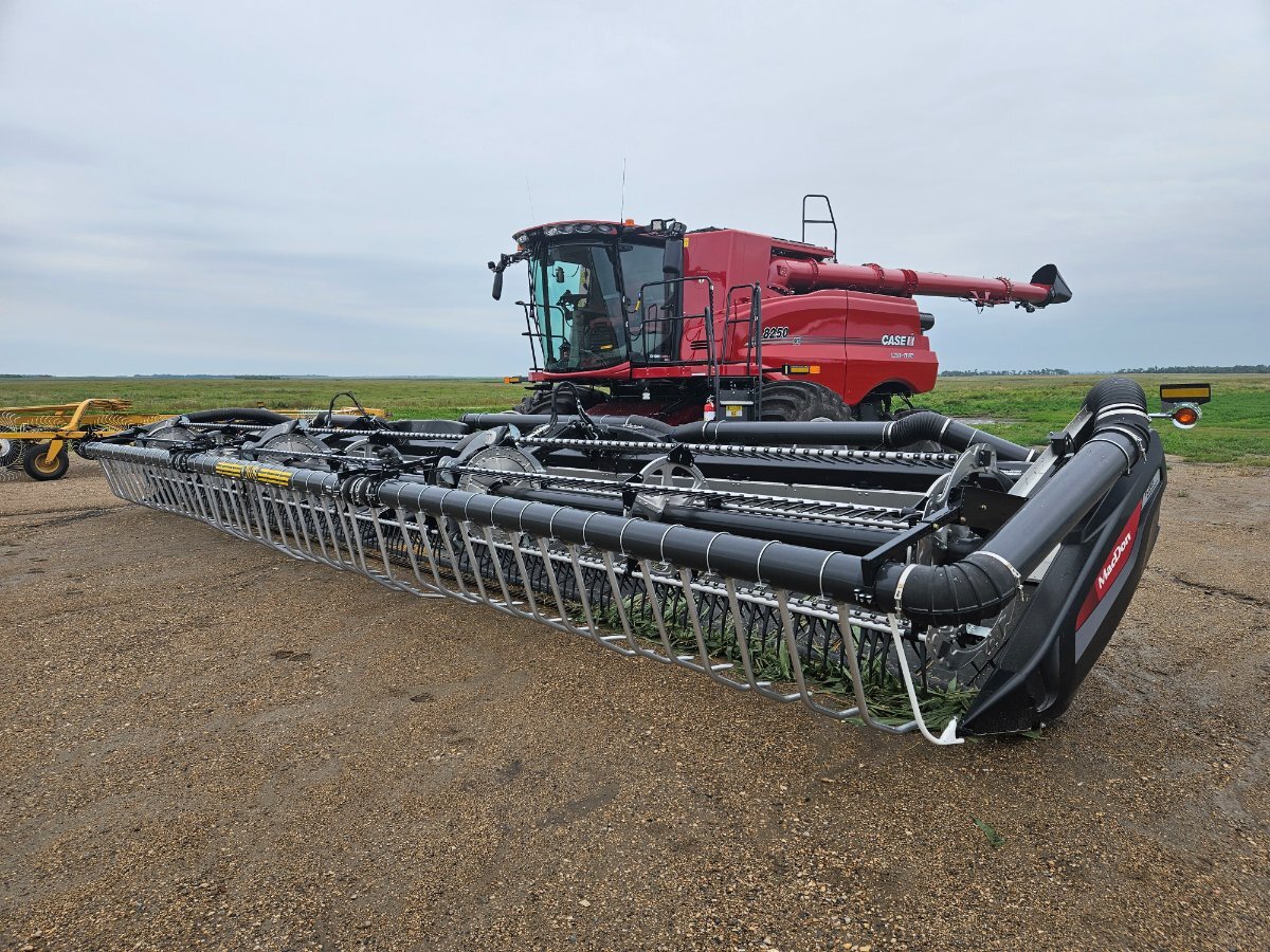

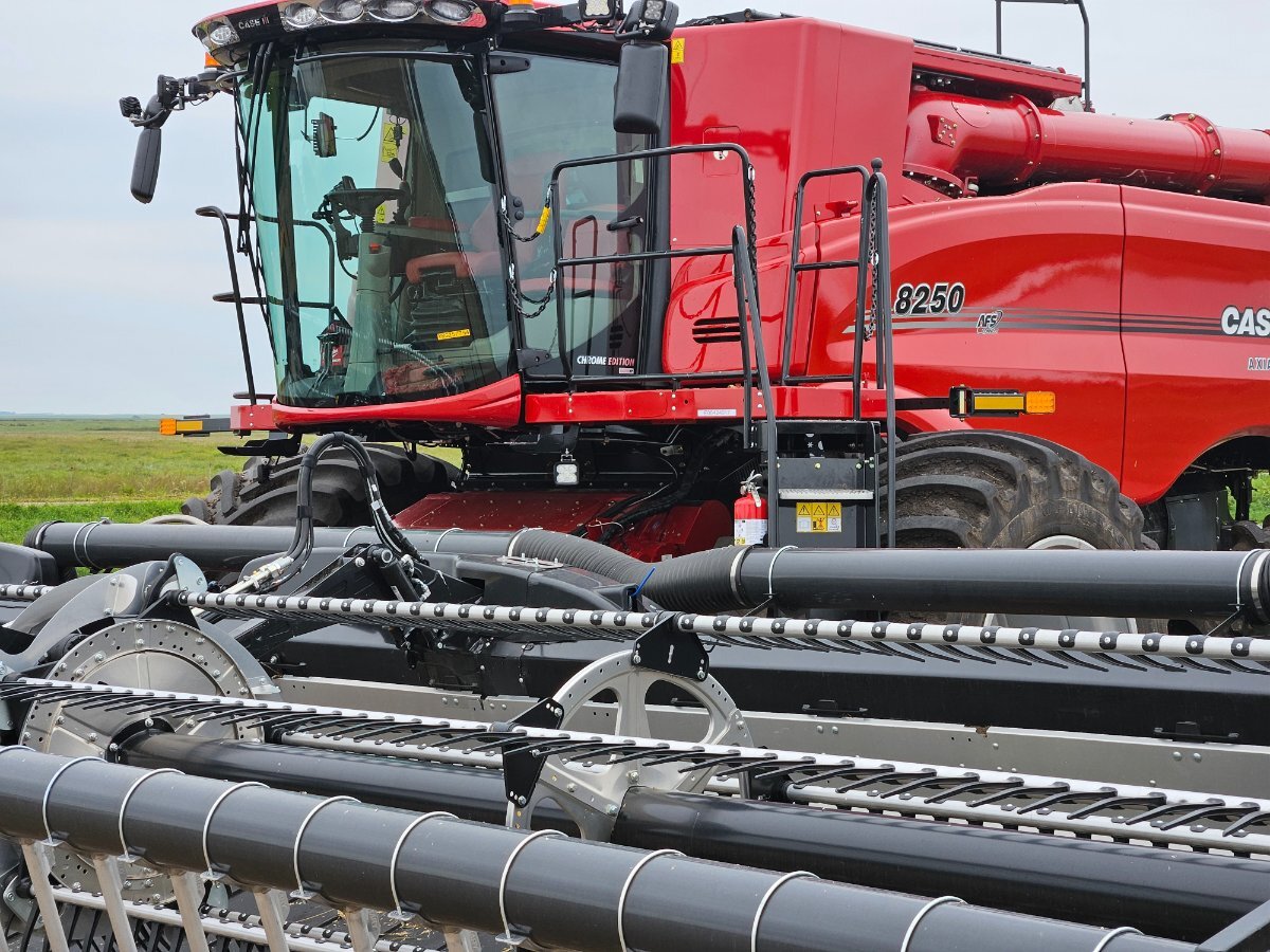

SDman Posted Monday at 04:04 AM Posted Monday at 04:04 AM 30 minutes ago, acem said: An auger/draper header. That's complicated and heavy... Actually if you want to talk about a heavy header, do what all the guys around here have done in the last 2-3 years and put an air reel on the front end of a draper head. All that extra weight on the front end of the header really taxes most newer combines' lift capacity. This is for our common problem...short beans. 1 Quote
