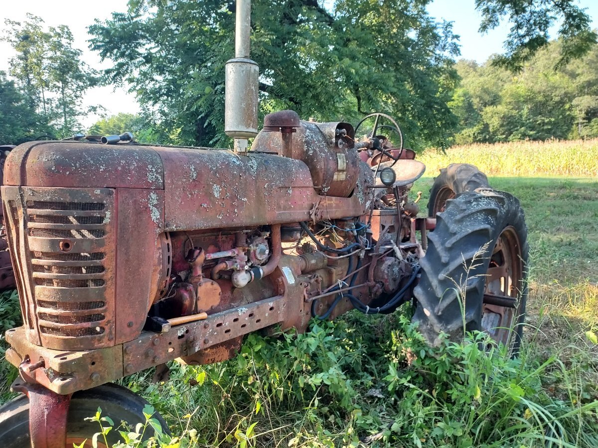

MacAR Posted July 25 Posted July 25 A few days ago, a cousin called me asking if I'd be interested in three old Farmall tractors... of course I am! Long story short, I got a wide and narrow front 400 LP and a single front 450 LP for under scrap price. He unloaded them for me on Wednesday, and I set to work. I decided that the single front 450 (last photo) would be the best one to start on, as it had nearly new looking oil and appears to be only lightly stuck. The others are stuck hard, and had about five gallons of water in the oil pans, so they will be the parts donors. Today, I drug the single front up by the shop and started to work on it. The engine is locked up, so I set it soaking with a bit of help on the crank pulley: It was also stuck in 1st gear, but a bit of Kroil and a long bar got it back in neutral. I'm sure I'll have a lot of questions as I go along, but for now my focus is on getting the engine moving. At that point, I'll start going through everything else little by little and hopefully have a running, driving tractor by this time next year. 12 Quote
