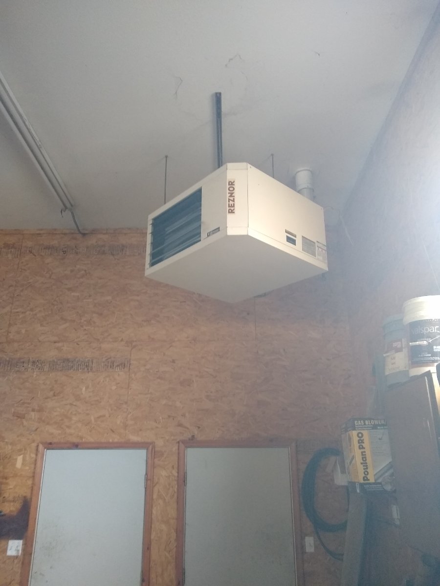

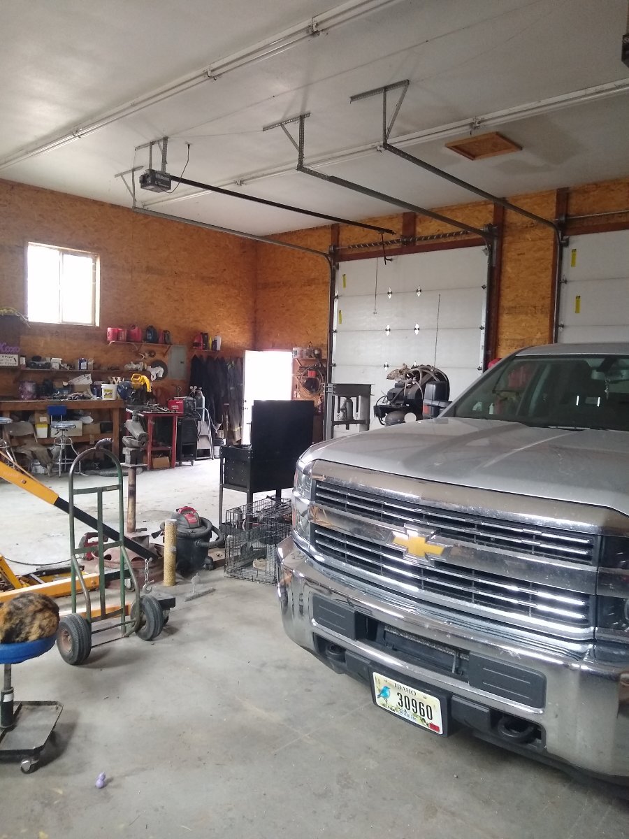

cobfly Posted November 16, 2025 Posted November 16, 2025 Reznor, 150,000 btu. 36x40 shop, 14' walls, insulated to the nuts. 400 gallon propane a winter, 55f minimum, 65f when I'm in it. I would not have electric where I live and we are 12 cents a kilowatt hr. 2 Quote
