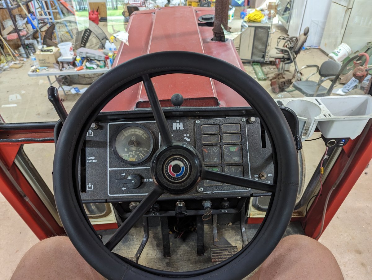

gafarm49 Posted September 22 Share Posted September 22 I use these. It fills up my hand better. My joints are stiff and I like a fatter grip. They are cheap and hold up fairly well 1 Quote Link to comment Share on other sites More sharing options...

FoxrunFarms02 Posted September 23 Author Share Posted September 23 On 9/21/2023 at 8:01 PM, gafarm49 said: I use these. It fills up my hand better. My joints are stiff and I like a fatter grip. They are cheap and hold up fairly well Is that just a bigger legit steering wheel cover? Quote Link to comment Share on other sites More sharing options...

gafarm49 Posted September 23 Share Posted September 23 22 hours ago, FoxrunFarms02 said: Is that just a bigger legit steering wheel cover? No I don't think so. You really have to stretch it to get it on and when you do it stays in place really good. I know it may look tacky but its really comfy on the hands. I put on on my 986 4 post last spring that rarely is inside and it still looks new 1 Quote Link to comment Share on other sites More sharing options...
FoxrunFarms02 Posted September 24 Author Share Posted September 24 3 hours ago, gafarm49 said: No I don't think so. You really have to stretch it to get it on and when you do it stays in place really good. I know it may look tacky but its really comfy on the hands. I put on on my 986 4 post last spring that rarely is inside and it still looks new Before I posted the question I bought a 12.00 cover like that from fleet farm I believe 15 inches was the biggest one and the steering wheel is 18. I got it almost on and it ripped apart. Yours looks pretty decent. It does what it's supposed to and if it feels comfortable and works for you that's awesome. 1 Quote Link to comment Share on other sites More sharing options...
ny bill o Posted September 24 Share Posted September 24 I have one of those covers on the 400. When it is outside in the rain, it collects water as it is open to the inside of the wheel. I'd just get a new one and be done with it for years. 3 Quote Link to comment Share on other sites More sharing options...
gafarm49 Posted September 24 Share Posted September 24 10 hours ago, FoxrunFarms02 said: Before I posted the question I bought a 12.00 cover like that from fleet farm I believe 15 inches was the biggest one and the steering wheel is 18. I got it almost on and it ripped apart. Yours looks pretty decent. It does what it's supposed to and if it feels comfortable and works for you that's awesome. they have the 17 and 18 in on amazon Quote Link to comment Share on other sites More sharing options...
