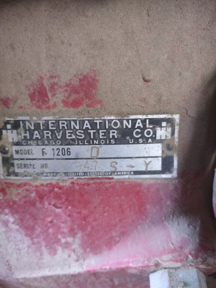

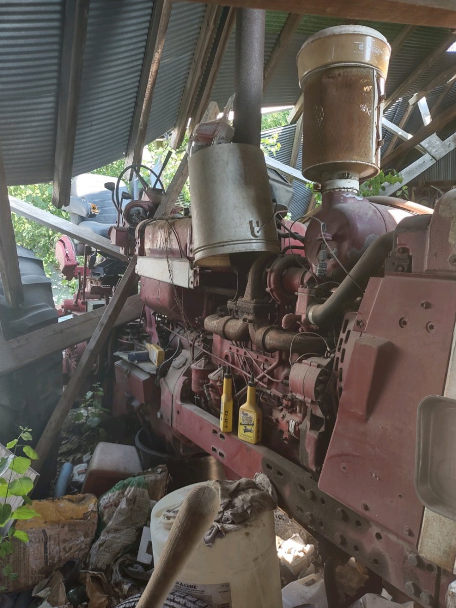

tmu205 Posted September 15 Share Posted September 15 Found this under a collapsed pole shed. From what I understand it was parked 25-30 years ago. Working on getting it home. 13 Quote Link to comment Share on other sites More sharing options...

Drysleeves Posted September 16 Share Posted September 16 Early '67 1 Quote Link to comment Share on other sites More sharing options...

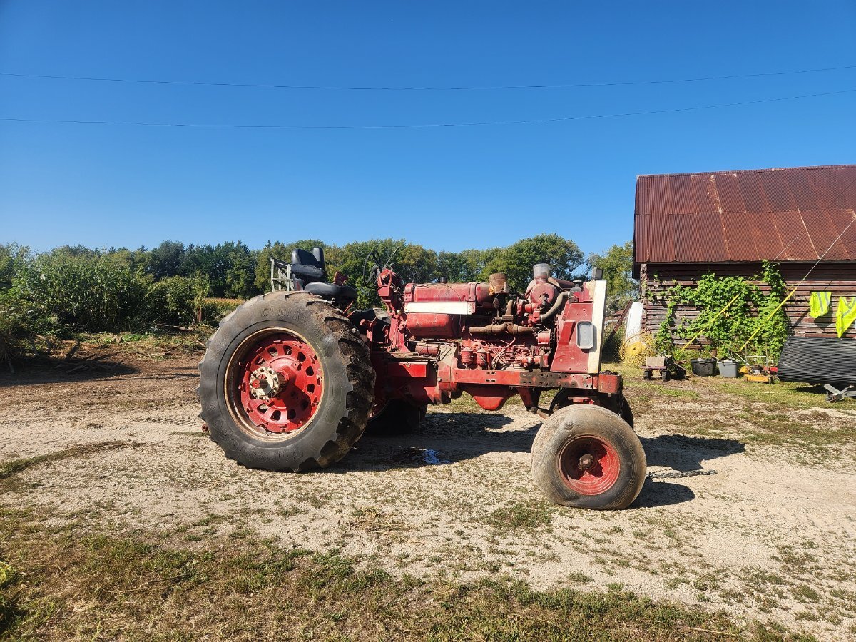

tmu205 Posted September 17 Author Share Posted September 17 It's outside 16 1 Quote Link to comment Share on other sites More sharing options...

Dzldenny Posted September 18 Share Posted September 18 Nice! At least it had some sort of cover. Do you know why it was parked and torn down? Is that a bottle of jack oil on the frame rail dated 2012? Quote Link to comment Share on other sites More sharing options...

tmu205 Posted September 18 Author Share Posted September 18 1 hour ago, Dzldenny said: Nice! At least it had some sort of cover. Do you know why it was parked and torn down? Is that a bottle of jack oil on the frame rail dated 2012? Yes it is, I was told this tractor has been sitting 25-30 years Quote Link to comment Share on other sites More sharing options...
35desoto Posted September 20 Share Posted September 20 A true barn find! Even though that roof had collapsed it looks as it still gave protection from the weather Quote Link to comment Share on other sites More sharing options...

Drysleeves Posted September 22 Share Posted September 22 Nice I see the correct parts and straight sheet metal including the Farmall badges and what might even be the original cob piler exhaust pipe. Just have to ante up for a set of reproduction 1206 number plates, rubber knobs, etc., etc., etc. Quote Link to comment Share on other sites More sharing options...

1480x3 Posted September 22 Share Posted September 22 Blow up that tire and dig the 7 btm out of the weeds !!! Quote Link to comment Share on other sites More sharing options...
tmu205 Posted September 22 Author Share Posted September 22 Batteries and fluids first, oh and find if it runs would probably be a good place to start 1 Quote Link to comment Share on other sites More sharing options...
Drysleeves Posted September 22 Share Posted September 22 I'm guessing it's loose since it was under at least some degree of a roof. Quote Link to comment Share on other sites More sharing options...
tmu205 Posted September 22 Author Share Posted September 22 Yes motor is free 1 Quote Link to comment Share on other sites More sharing options...
Drysleeves Posted September 22 Share Posted September 22 Could be very exciting Quote Link to comment Share on other sites More sharing options...
hillman Posted September 22 Share Posted September 22 2 hours ago, tmu205 said: Yes motor is free you didn't ask for my free advice but, I would take valve cover off and make sure all valves are opening, have injection pump and injectors gone over, and get a preluber when you change engine oil Sounds like overkill to some but we are talking a 1206 man👍 theres very few out there worth the trouble ! its a 1206 ! 1 Quote Link to comment Share on other sites More sharing options...
