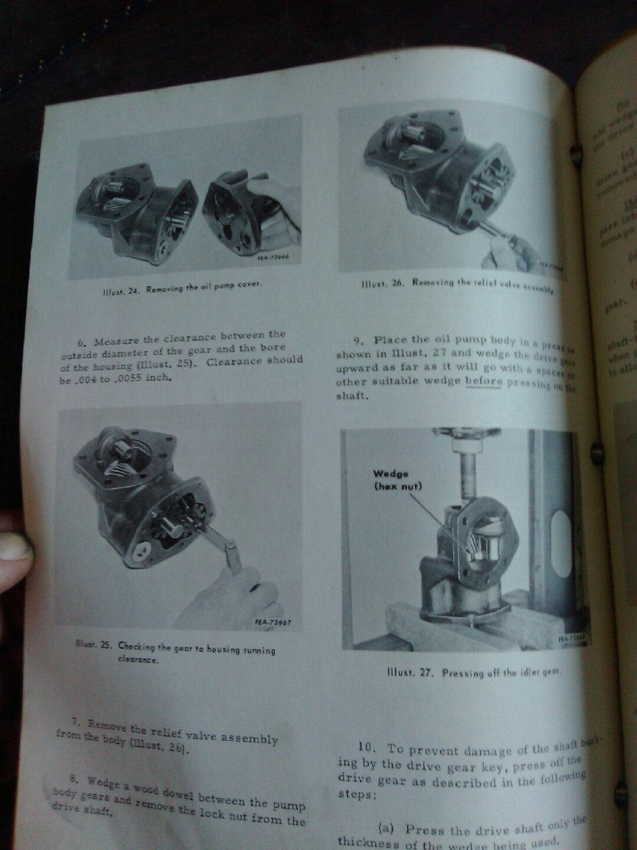

FarmerFixEmUp Posted September 18 Share Posted September 18 My 806 takes a few seconds to prime the oil pump and kick off the light when cold. But it has over 16000 hours on it too. Oil pump's never been off and we've owned it since around 1500 hours in 1971. Sleeves and pistons were replaced at 13xxx hours. They were original until then. There's an oil pressure valve behind the rear header of the engine oil cooler that's below the level of the filters. 15 - 19 in the picture. Someone mentioned low oil pressure. The spec hot is 38-55 psi at rated rpm. Since these tractors only had oil and amp lights the oil pressure is usually unknown. Also the safety valve is in the oil pump. Quote Link to comment Share on other sites More sharing options...
