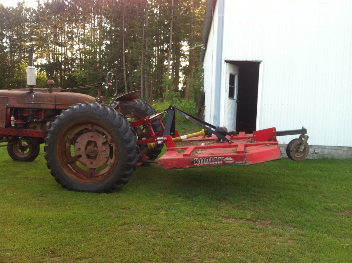

Mudfly Posted September 7 Author Share Posted September 7 Pic from 2015. Don’t have anything newer but it was holding air until 2020. Yes it was rusted already then, but still holding air and usable. 2 Quote Link to comment Share on other sites More sharing options...

hillman Posted September 8 Share Posted September 8 6 hours ago, db1486 said: . Had a few pucker moments right there! some tractors power to weight ratio are unsafe without loaded tires, not to mention useless, Nebraska Tests load them down for a reason. Jobs like that M mowing don't require fluid I find it humorous when someone says they had the tires pumped out and put a set of weights on instead. It takes a lot of iron to add up to that fluid go to a plowday with hard dry soil and watch identical tractors one with one without, I have actually experienced this in wet soil. Same tractors ,same plow, Started out with nicer tractor and it wouldn't pull the plow in low areas, Had to go get same model with loaded tires and had no issues at all 2 Quote Link to comment Share on other sites More sharing options...

Mudfly Posted September 8 Author Share Posted September 8 2 hours ago, hillman said: Jobs like that M mowing don't require fluid Yep. I believe those tires hold around 500# of fluid. I have 3 more sets of weights if needed. But I'm going to start with 1 additional set (2 total). I don't need it for mowing, but might in the woods pulling trees out. Chains also help with that as we do all our in woods work in frozen conditions. Quote Link to comment Share on other sites More sharing options...
