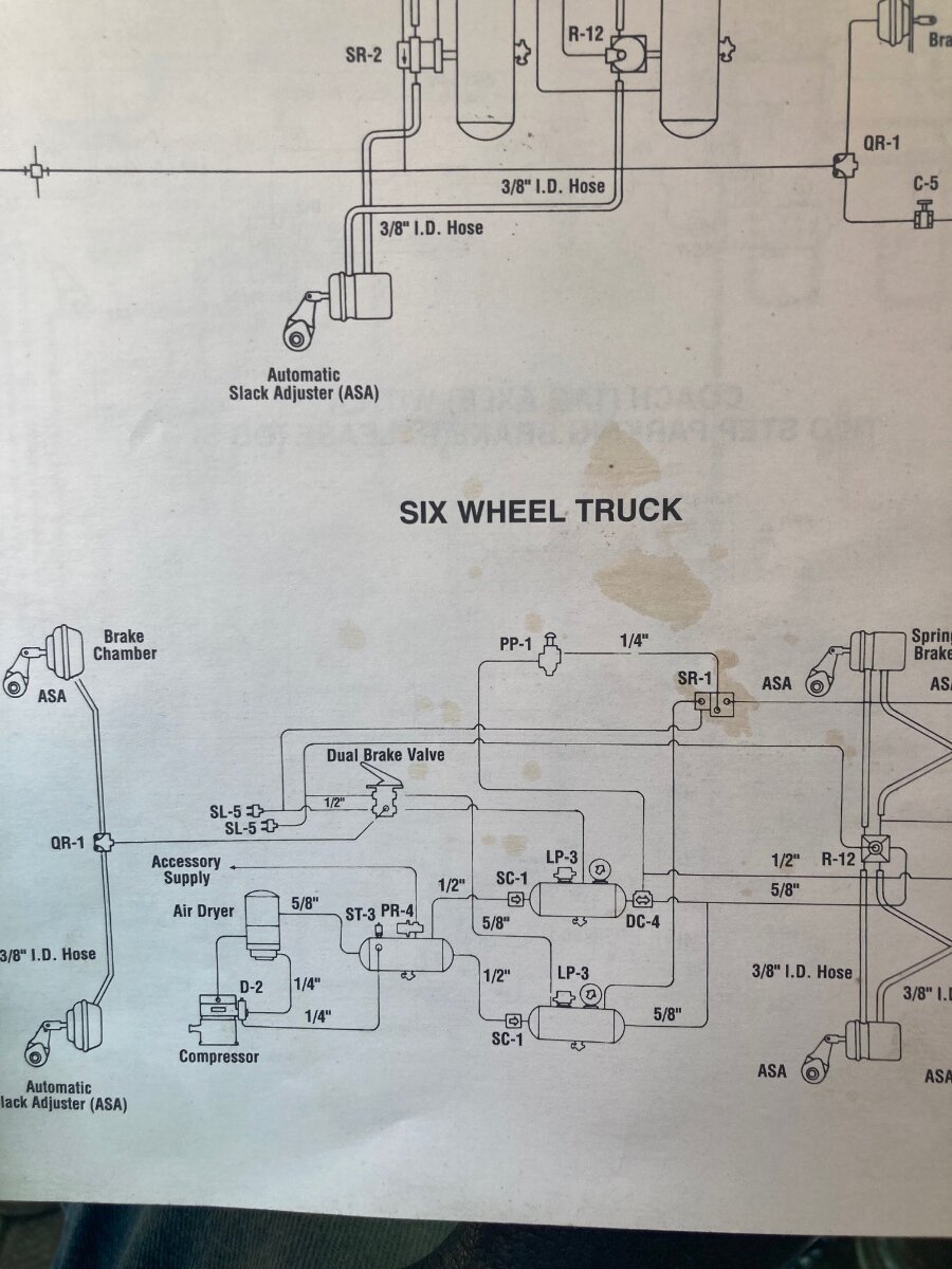

No, I was referring to an ordinary reservoir relief valve. Pull up a generic air schematic online and see if there is supposed to be a check valve downstream from the dryer ( or look on your truck) because an awful lot of air is backflowing; the dry should only blow out what’s in the dryer, not drain the whole system. Has anyone worked on the truck ( other than what you have done) , or did it just start doing this by itself?

It's definitely coming out of the bottom of the air dryer. I'll take a look and see if there's another relief valve somewhere. I have what I think is all of the paperwork that came with it when it was delivered in 1992. I know there is electrical schematics in there. There are probably air diagrams as well.

I think @Binderoid is on the right track. I had the same issue on one of my trucks earlier this year.  Turned out that I had to replace a check valve between the air dryer and the air tank.

I’m not so sure now… the signal line coming from the unl port on the governor is under pressure at the dryer the entire time the compressor is unloaded. So, air coming out of the exhaust on the dryer could be from the governor and not necessarily backflowing from the reservoir. It would be easy to blame the dryer at this point, but he replaced it. Also, why did the old one start doing it to begin with?
