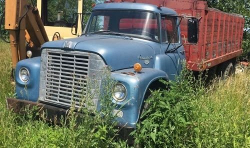

I currently have a 1962 Farmall 560 diesel and a 1952 Farmall Cub. I have a vision for a Loadstar antique tractor hauler...  I am looking for advice or thoughts on some of the trucks in consideration.
I am looking at the earlier models, up to 72.  I like the curves of that body style. Most of the trucks around this area have some rust, most of the fender tops are pretty rough. I like the idea of air brakes and there happens to be a '67 with air a couple hours north of me.  It has some rust, holes in fenders, and does not have a bed on it.   It is pretty cheap for those reasons.
Next is a '64 with hydraulic brakes.  It has some rust, only one fender currently has a hole in it, but it does have the grain bed on it.  It is about 30 minutes from me, might take a look at it this weekend.  I think it has been setting for a year and according to the description it needs a new master cylinder.   From my reading, it seems like even after a few hundred $ in master cylinder, I may end up chasing brake lines and vacuum lines?
This morning a '72 popped up about an hour from me and I am planning to take a look Saturday.  From pictures, the body is in great shape, minimal rust, can't see through the fenders.   Grain bed is there and working PTO dump.  The description says the brakes work currently but the master has a leak.   If the body is truly as nice as I'm hoping, I'm willing to chase some brake issues.  Brake issues seem better than severe rust issues.

I ended up buying the one that was about an hour away from me and the seller transported it for me.   Brakes work pretty well.   I took some cutting compound to the multiple colors of oxidized red and brought back some shine.  Didn't get to the roof yet.  Overall I am pretty happy with the truck.
image.jpeg.bf2798cbf6666a3b1591f25c42b96fad.jpegimage.jpeg.ef282c842adcbc17a9495bf16e8d99ab.jpeg
