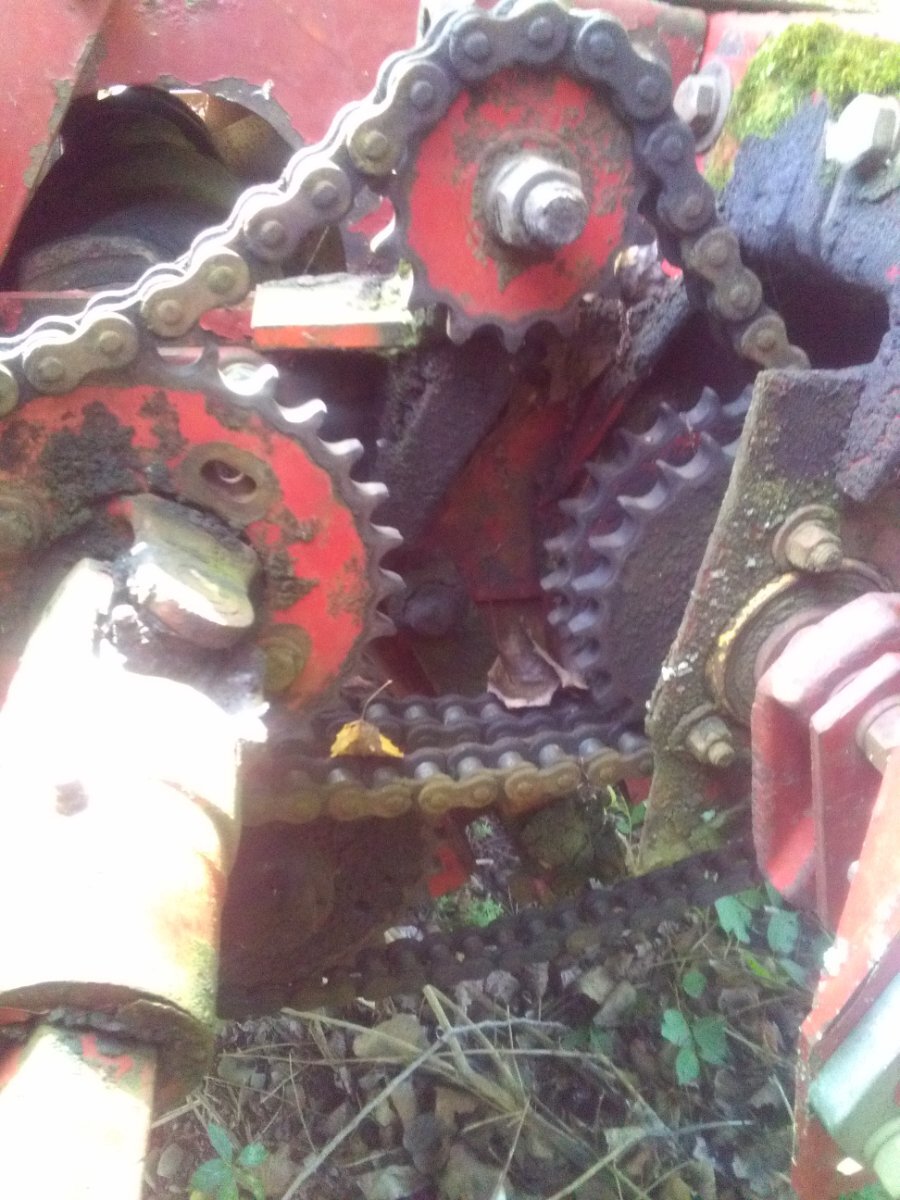

Baradium Posted August 8 Author Share Posted August 8 On 8/6/2023 at 9:53 AM, ny bill o said: this is my 114. It was pretty well used up before I got it 30 years ago, and the conditioner rolls kept losing time, which made the conditioner plug (takes 14' of hay and puts it through a 4' conditioner). I finally figured out that the top chain tightener was missing, and the PO had just shortened the chain. After I built a new mount for the idler sprocket and got the right number of links in the top chain, the problem went away. Mower still gets used occasionally, like a new seeding that may have rocks that would beat up the disc mower. Problem is, the 114 can only windrow the hay, not lay it flat to dry. The number of links in the chains matter? One whole chain is missing so I have to put a new one on without a template. Guess I should order a manual Quote Link to comment Share on other sites More sharing options...
ny bill o Posted August 8 Share Posted August 8 9 minutes ago, Baradium said: The number of links in the chains matter? One whole chain is missing so I have to put a new one on without a template. Guess I should order a manual the conditioner was In Time-Out of Time-In Time-Out etc. It would plug repeatedly, got so bad that I was carrying a huge pipe wrench on the tractor to turn the rolls backward. If I can remember, I will look up the number of links in the manual in the morning. IIRC, the bottom chain is direct drive. The top chain has the idler to take up the extra links. Quote Link to comment Share on other sites More sharing options...

Baradium Posted August 8 Author Share Posted August 8 4 hours ago, ray54 said: No chain involved in my knife drive. A belt under cab to drive line along the back top of header to bar that wobbles to drive knife back and forth. But moving drive shaft and universal joint orientations I could change mine to run in sink rather than to cross. So on this one there is the hydraulic motor that runs a set of gears and that runs two chains. One chain runs the lower roller and one runs the top. The top roller has a driveline out of each side that goes to a flywheel with a bent stub end that wobbles the shift that works the knife on each respective side. Quote Link to comment Share on other sites More sharing options...
ny bill o Posted August 10 Share Posted August 10 I finally remembered to look in the owners manual for the number of chain links. The top chain is 54 pitches of #60 chain. Bottom is 74 of #60 chain. Without the correct number of links, the conditioner won't keep time and will plug. I forgot that the bottom chain goes thither and yon, my top chain was the one that was straight linked between the sprockets. Here is the tightener that I built to use up the required number of links on the top chain. There was nothing on the machine where the orange piece is welded on. Gusset welded on under the orange piece. The slotted piece is flat steel that met up with Mr. Torch. Idler sprocket is common NH issue for #60 chain. Quote Link to comment Share on other sites More sharing options...

ny bill o Posted August 12 Share Posted August 12 On 8/10/2023 at 11:13 PM, stronger800 said: I have never been around one of those machines, but that’s how the manual says the missing idler is supposed to be oriented? According to a picture in the manual, the factory idler was above the chain. different construction, though. The factory idler was pushing down on the chain rather than holding it up. Quote Link to comment Share on other sites More sharing options...
