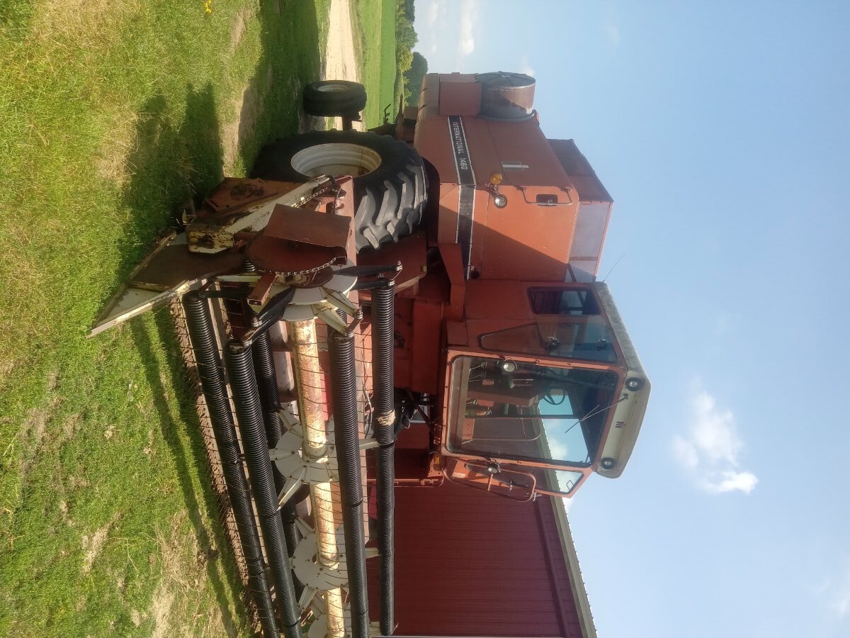

Solocam8925 Posted August 4 Share Posted August 4 I just brought my first combine. Was told that the brakes haven't been working since 1980. You can't even stomp on the brakes. Any suggestions?? Is it worth fixing the brakes?? Quote Link to comment Share on other sites More sharing options...
