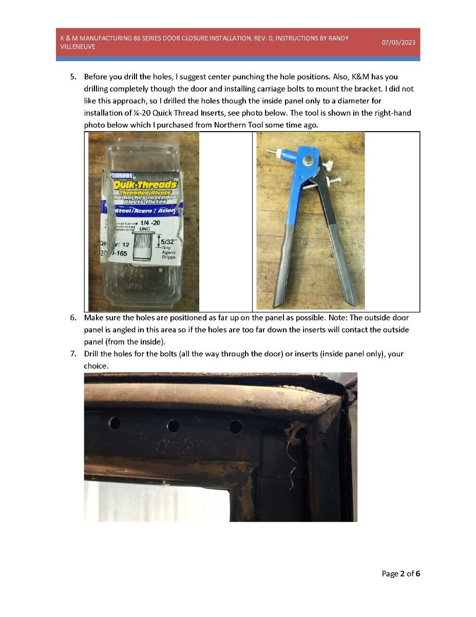

Buick455GS Posted July 5 Share Posted July 5 I installed the K & M door closures on both of the doors on my IH 886 this past weekend. The installation that I performed is outlined below for those that may need better instructions: 1 Quote Link to comment Share on other sites More sharing options...
Matt Kirsch Posted July 5 Share Posted July 5 Looks like you found the same thing that I did, which is the measurements for the bracket on the door frame are BARELY enough to allow the cylinder to compress with the bracket slid as far back as it will go on the slots. 1 Quote Link to comment Share on other sites More sharing options...

Tunneldigger Posted July 12 Share Posted July 12 Thanks for the pictures. I guess I never knew anyone made such a closer. Quote Link to comment Share on other sites More sharing options...
