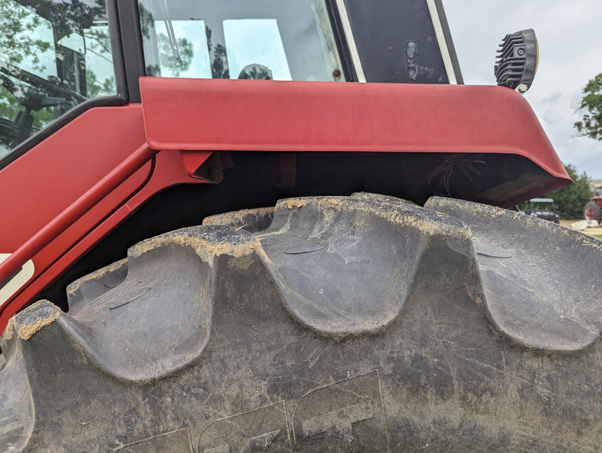

gafarm49 Posted June 3 Share Posted June 3 set on 36 in rows, will they fit? I put them on a 4840 and now it runs 21mph in road gear. It wouldn't hurt to speed the 1586 up and having 1rst high faster would be good Quote Link to comment Share on other sites More sharing options...

gafarm49 Posted June 14 Author Share Posted June 14 Might be just enough room Quote Link to comment Share on other sites More sharing options...
INTERNATIONAL 1466 Posted June 20 Share Posted June 20 The fender isn't as much the problem as in front of the tire. Gets too close by the door so to speak. This is why 20.8x42's fit on an 88 and not an 86. The wheels are further rearward on an 88 allowing them to just fit. 1 1 Quote Link to comment Share on other sites More sharing options...
