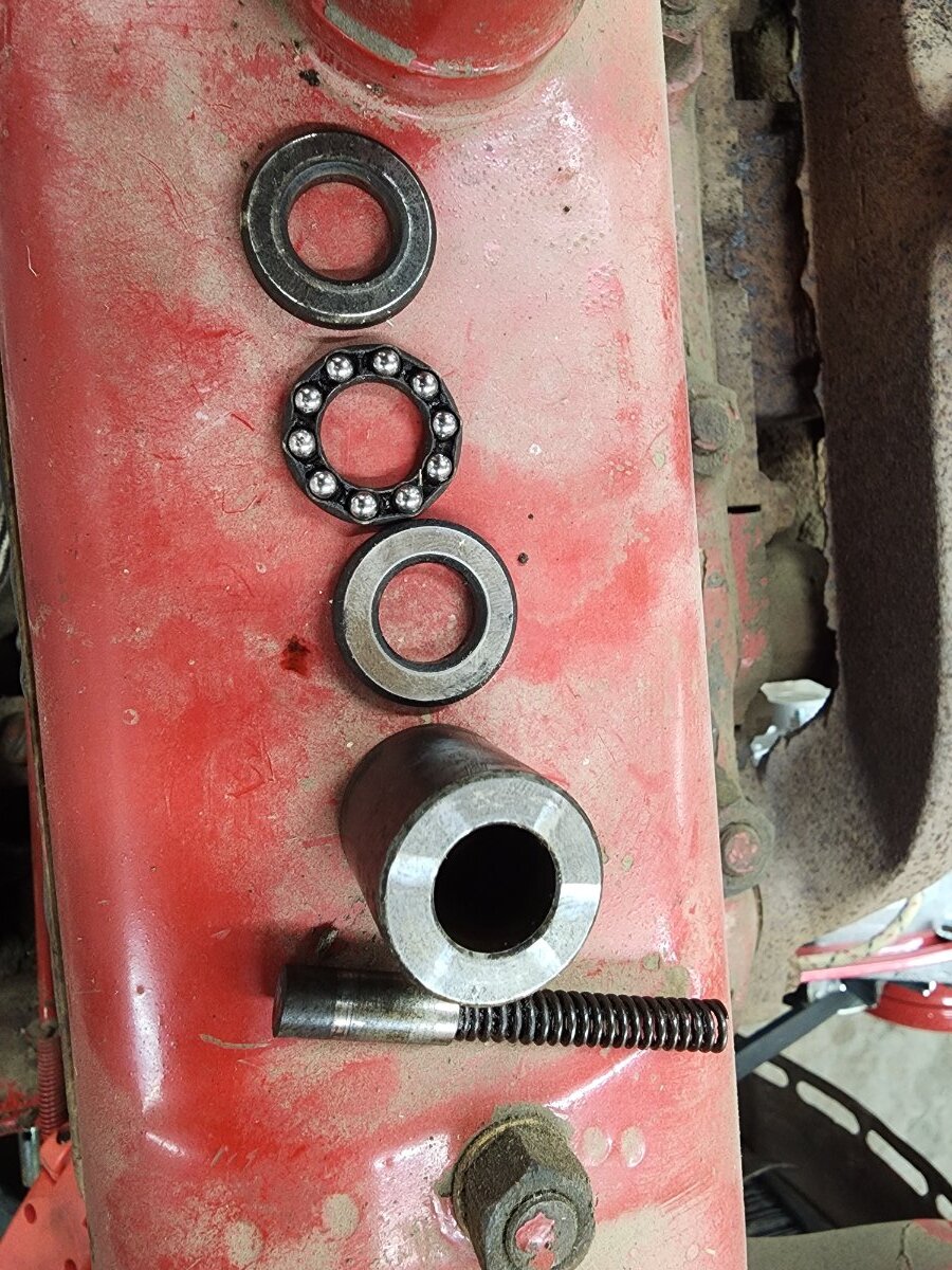

OFFTHEFARM Posted June 14 Share Posted June 14 Don't want to highjack Minnesotafarmall thread but this is what mine looks like. It appears everything is in one piece. The only strange thing is the sleeve is steel instead of plastic and the thrust bearing wore grooves in the sleeve and one of the races. Spring is ok too. 1 Quote Link to comment Share on other sites More sharing options...

OFFTHEFARM Posted June 16 Share Posted June 16 Did yours look similar to mine? Best I can tell everything in mine looks fine but it runs wide open all the time. The spring isn't broke or unhooked either. Quote Link to comment Share on other sites More sharing options...
MinnesotaFarmall Posted June 17 Author Share Posted June 17 18 hours ago, OFFTHEFARM said: Did yours look similar to mine? Best I can tell everything in mine looks fine but it runs wide open all the time. The spring isn't broke or unhooked either. Yes, same set up. Only thing I can think of your problem is the governor shaft to carb is broken, or the arm that pushes up against the spacer had fell down and got caught so it was binding thus causing it to go to full throttle. Or, simply, there is a pin missing. Quote Link to comment Share on other sites More sharing options...
