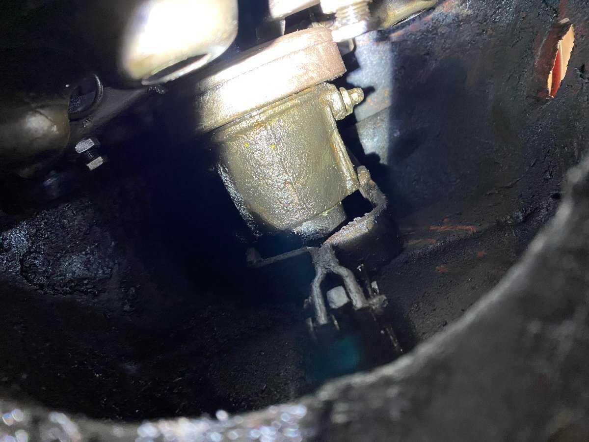

Another issue I discovered on my short test drive is that the clutch slips.  Investigated further and I think the throw out bearing is installed incorrectly.

I was able to get the clutch fork removed and reinstalled correctly last night.  Maybe tonight I can get the linkage adjusted and go for another test drive.
