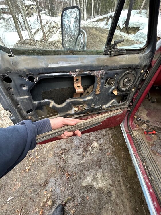

AKwelder Posted April 29 Author Share Posted April 29 Here is my bracket like I said, it’s an old beater Quote Link to comment Share on other sites More sharing options...
IHKeith Posted April 29 Share Posted April 29 I'd use urethane sealer, the type intended for windshields. When I worked at a GM dealer, urethane was the approved adhesive used for such repairs. The truck doesn't look too bad in the pics, old but no rust blisters or holes visible, and the window track doesn't look rotten, it's a gem!! 3 Quote Link to comment Share on other sites More sharing options...
lotsaIHCs Posted April 29 Share Posted April 29 When I worked in a body shop in high school (many years ago!) We used something called channel grip for windows like that. It comes in a roll and in different thicknesses. It's kind of a rubberized cork looking product. Also heard it called window grip. My 56 chevy pickup uses it on the windows. Urethane works great for that also, but if you ever break a window you have to dig it out of the channel to install a new one. I also used The Right Stuff on a pickup window once and actually still have it. The window is still in it and rolls up and down just fine. I gave it a few days to fully cure before using the window though. 2 Quote Link to comment Share on other sites More sharing options...
Ian Beale Posted April 29 Share Posted April 29 When you get it back together puff powdered graphite on the window channels whenever the winder gets tight Quote Link to comment Share on other sites More sharing options...
stronger800 Posted April 29 Share Posted April 29 What they said. Clean it out and glue it in there with some adhesive. That windshield urethane is Strong. Real strong. Probably $50 a tube though. Quote Link to comment Share on other sites More sharing options...
tinnerjohn Posted April 29 Share Posted April 29 Urethane works good, be sure everything is clean and use something at each end of the channel to keep it centered on the glass. The cardboard cover fron single edge razor blades works good. I've seen doorglasses break for the channel being cocked on the glass! 1 Quote Link to comment Share on other sites More sharing options...

lotsaIHCs Posted April 30 Share Posted April 30 Broncograveyard.com has what you are looking for. They call it window setting tape or something similar. If you can't find that, the urethane or other thick adhesives like the thick spreadable flex seal would work. This is a picture of what Bronco Graveyard shows. They also have the channels available too. 1 Quote Link to comment Share on other sites More sharing options...
