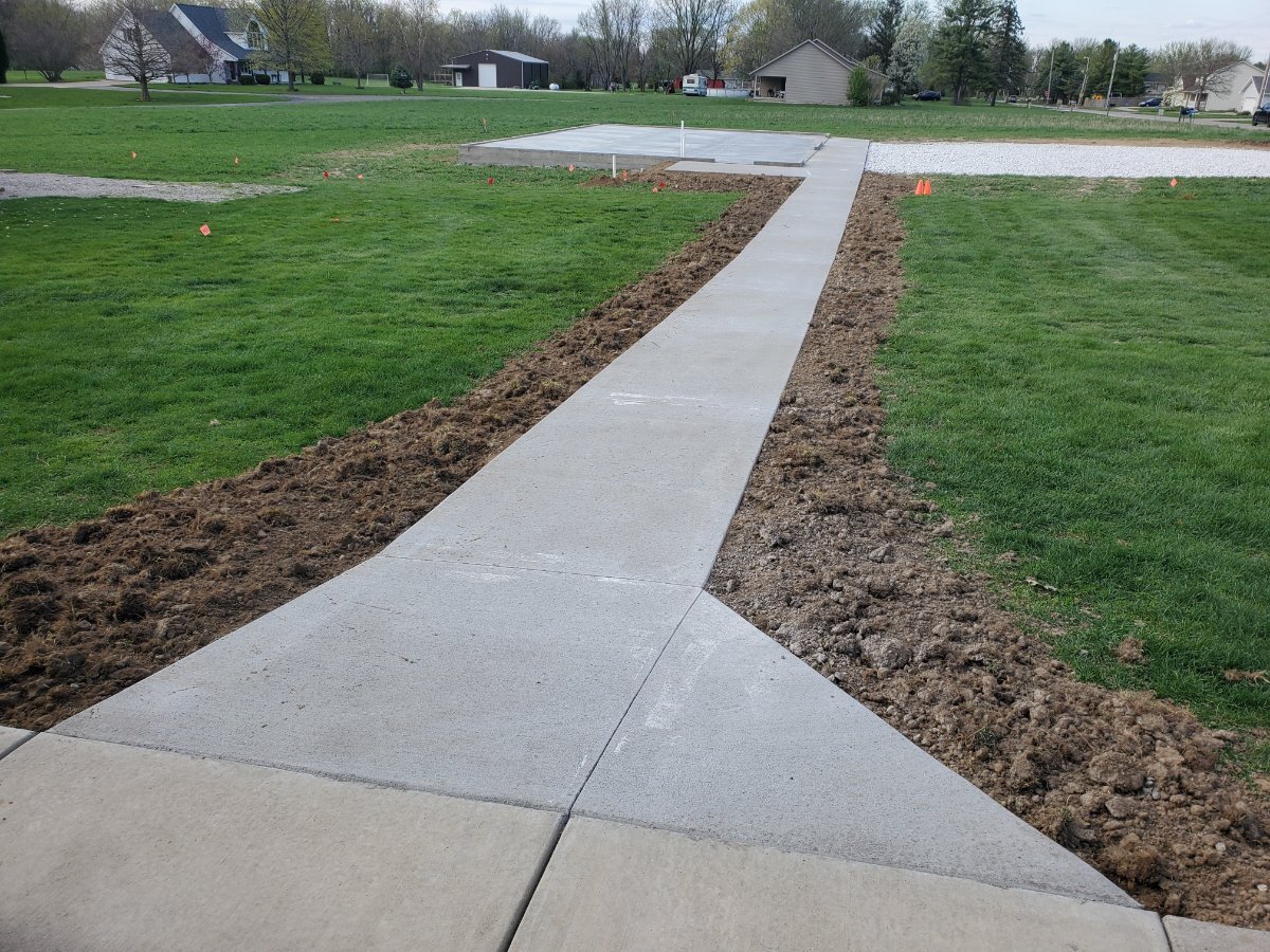

Concrete crew was here today.....13 hours and 38.5 yds later, I have a shed footing/floor and new sidewalk and shed approach.
  • Like 6

Sidewalk rough back filled before rain......floor drains well....had over an inch of rain to test it out!

Looks like one of the neatest kept job sites I’ve ever seen.   Do they make you anchor walls with cement anchors down there or something similar??
Posted
Sill plates get anchored to concrete curb with epoxy anchors when walls are installed.   Builder prefabs walls on steel jig then hauls them out, stands them up, and anchors them down.
Concrete crew did great.....30x48 and square within 1/4" on diagonals.
Thanks for comment on job site.....since it's my yard I try not to let it run wild.
