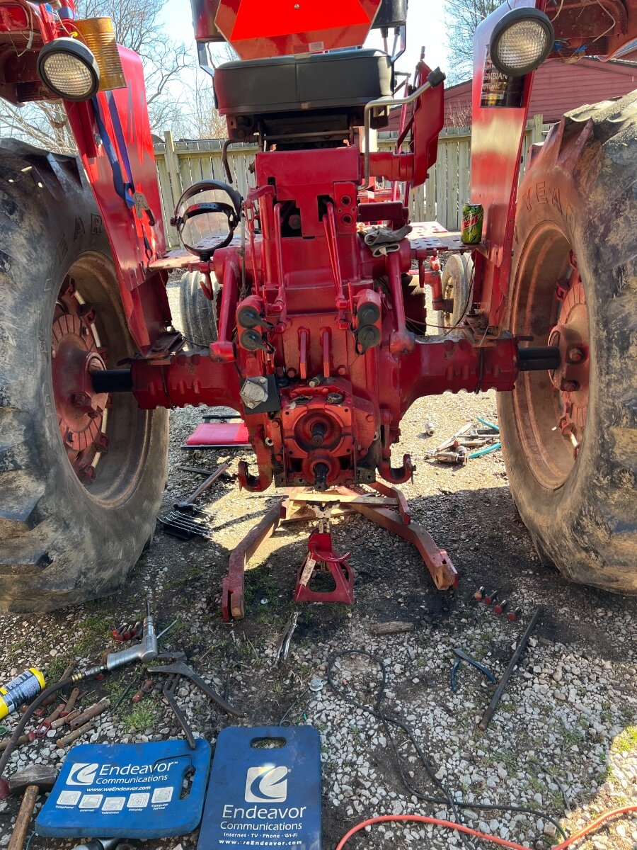

1 minute ago, brahamfireman said:
I assume the lift arm was seized on the shaft and you couldn't get it loose so you cut the shaft?
Yes the left was. Plus the threads got messed up and I broke a tap off inside of it.
I’ve neglected the TLC on the ole girl for the past few years and she’s making me pay for it now. Lol

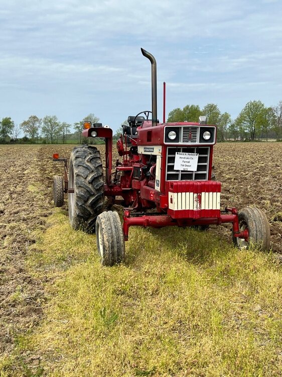

Well it’s been a spell since I started this thread and such so here’s an update. Finally got the hitch all straightened out and am very happy with the swapped setup. A couple of years ago I was able to buy a 7 shank, 3 row model 55 chisel plow. Another friend needed help this spring in a field so I got to test the ole girl and plow and was very pleased. I’m going to try an post a video
