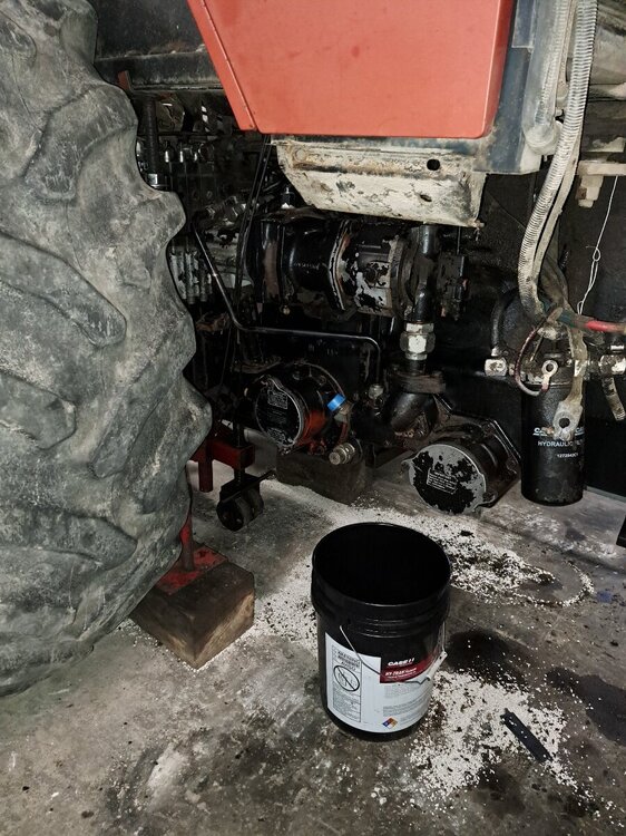

Caseihtecher Posted March 17 Author Share Posted March 17 Well today got the range housing finished up and hung back up on the rear. Also got the new pads and plates in the master clutch and it reinstalled. Which by the way if you need them, buy plates from A&I. That's where Case Ih gets the from.. learned that the hard way.. anyways got the valves hung up and started throwing lines back on. Should be ready for the pump drive and pumps. Then should be ready to roll it back together. Of course that'll wait till Monday. Now hopefully I'll get sometime this weekend to work on the H. 5 Quote Link to comment Share on other sites More sharing options...

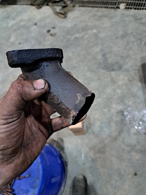

Caseihtecher Posted March 24 Author Share Posted March 24 Well yesterday I spent most of the day trying to get little odds an ends done in the shop. Mostly catching up with some lawnmower work. Yes I get to help with those time to time. 🙄 Anyways besides that I got that cylinder on that sprayer pulled off and rebuilt. Also had a hose on it that was rubbing that I had to replace and try to get it to atop running. Spent most of the day out in the field replacing an exhaust manifold on a Mx285. It's a good thing too because it was broke. And also had to rebuild a hitch cylinder. Which was rebuilt on the tractor do to Case Ih's wonderful design of putting pins into blind holes with no anti-sieze.. would it really cost much to use some of this stuff when things are being built? 2 Quote Link to comment Share on other sites More sharing options...

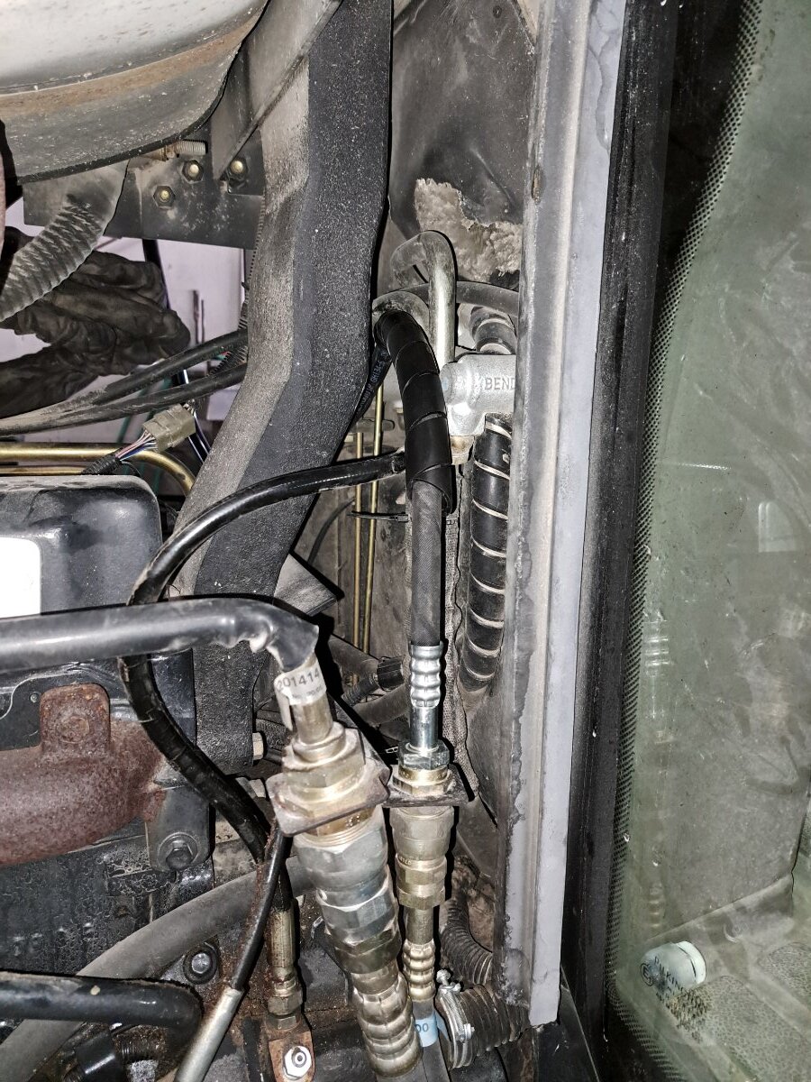

Caseihtecher Posted March 30 Author Share Posted March 30 Well I'm getting to enjoy the nice Missouri weather today out and about.(before the storm weather) started out this morning working on MXM130 replacing an A/C hose and receiver/drier due to a major leak. Got that fixed and charged up. Though something still doesn't seem right, but I'll look into that when I get back to the shop. Got my starter replaced on that 540 steiger.. Boy that was something, let me tell you what.. I don't think they can cram anymore stuff in there. And Got the engine sensor replace on the 550 Quad and got that straightened out. Along with running it around and getting the transmission calibrated. Finished off the day checking out a Stx440 that wouldnt move. Ended up just needing some clutch pedal sensors adjusted. 3 Quote Link to comment Share on other sites More sharing options...

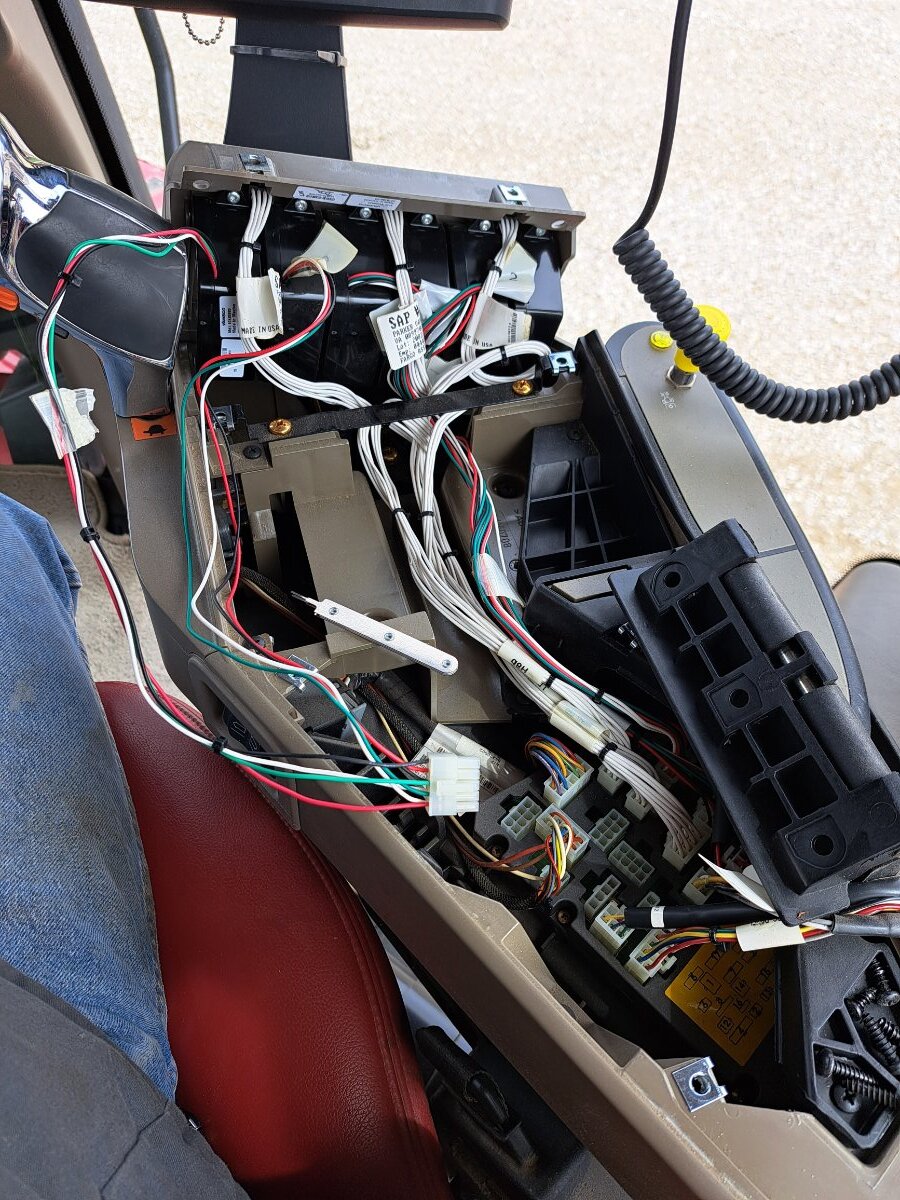

Caseihtecher Posted April 5 Author Share Posted April 5 Alright so today started out working on some lawn mowers and school buses. 🤮 yes we work on buses, we've done it for the school district ever since when we used to be an Ih truck and tractor dealer. But this afternoon I got to go out on a 580 Quad to check out and charge a/c. And replace some wonderful remote levers on a 540 steiger. If I feel healthy enough to go to work tomorrow I need to get some more running around done. 1 Quote Link to comment Share on other sites More sharing options...
Caseihtecher Posted April 7 Author Share Posted April 7 Well got some more knocked out in the last couple days. Replaced yet another remote lever on another 540 QT. Went out on a 335 and 385 Steiger that believe it or not they both had the same issue. Neither tractor would shift while moving, but if you push in the clutch you can change which gear you start out at up to 8th gear. Their are two possible causes. Either 1 of the 4 transmission speed sensors are messed up, or clutch pedal position sensor doesn't show the clutch pedal position all the way up. The 335 just needed the clutch pedal sensor recalibrated, as for the 385 I'm not sure. It kind of fixed it self while I was checking it out. 🤷 I also went out on a 450 QT for the wonderful "SCR Failure" screaming at the customer. Luckily it was only an expensive NOX sensor. And I finishes today off replacing the blower motor in a 315 Magnum due to the customer not appreciating the way it was howling. 5 Quote Link to comment Share on other sites More sharing options...
