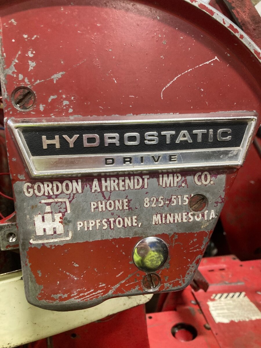

red_reaper Posted March 9 Share Posted March 9 Something to think about, since it's confirmed fender delete, and the WFE is off a 560, I wonder if it came with a single front wheel, or a narrow front? Is that setup popular up North for vegetable farms? 1 Quote Link to comment Share on other sites More sharing options...
Dmnstr8r Posted March 9 Share Posted March 9 49 minutes ago, red_reaper said: Something to think about, since it's confirmed fender delete, and the WFE is off a 560, I wonder if it came with a single front wheel, or a narrow front? Is that setup popular up North for vegetable farms? I have a 1456 that sold new in that part of the world, and know of another originally delivered as fender deletes. By 1970, ice cream box cabs had been replaced by diamond cabs, and were fairly expensive in relation to aftermarket. In researching, dealers in that area sold quite a few fender deletes, only to retrofit them with various aftermarket cabs at a lesser cost than a factory installed diamond cab. My 1456 wears the same platform, has rub marks on the cowling, side lights, no wiring through the cowling for a factory cab, nor was it wired for the factory turn signal assembly. Unfortunately, the bracket you still have is long gone. Neat find! 2 Quote Link to comment Share on other sites More sharing options...
Dzldenny Posted March 9 Share Posted March 9 Dad purchased our 1026 brand new locally in 71. Ours was not a fender delete but it received a Year-a-Round QT-1 cab before he took delivery. Dad remembers it being the cheaper option at the time. The original fenders were delivered as well and put to use on our 706. Quote Link to comment Share on other sites More sharing options...
nate Posted March 9 Author Share Posted March 9 4 hours ago, red_reaper said: Something to think about, since it's confirmed fender delete, and the WFE is off a 560, I wonder if it came with a single front wheel, or a narrow front? Is that setup popular up North for vegetable farms? The area the dealer stickers are from, I would say no. I’m guessing the dealer ordered it with little to no options to save a buck. MN had cozy, hinniker and I think year around cabs built right in Minnesota for options. 4 Quote Link to comment Share on other sites More sharing options...

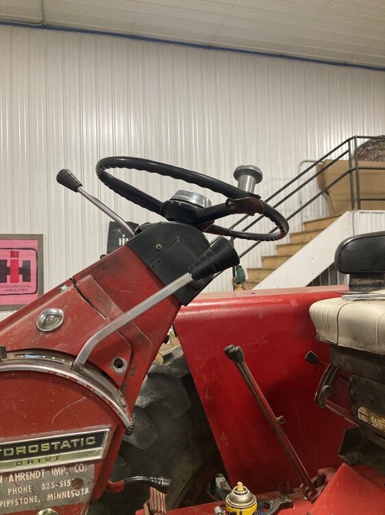

nate Posted March 20 Author Share Posted March 20 Been working on it when time allows…. New thermostat bypass hose, new fuel return line. Had a step kit laying around so my dad and brother fabbed a bracket for it. Tilt wheel got welded up and rebushed. Hydro quadrant grab handle got ordered. Got most of the tin put on. 4 Quote Link to comment Share on other sites More sharing options...
Drysleeves Posted March 20 Share Posted March 20 Where did you source the tilt wheel bushing? I have a 1456 that will need one soon. Quote Link to comment Share on other sites More sharing options...
nate Posted March 21 Author Share Posted March 21 On 3/19/2023 at 9:00 PM, Drysleeves said: Where did you source the tilt wheel bushing? I have a 1456 that will need one soon. Dad picked it up. I think it was 1” OD by 7/8” ID Quote Link to comment Share on other sites More sharing options...

nepoweshiekfarmalls Posted March 22 Share Posted March 22 On 3/19/2023 at 9:00 PM, Drysleeves said: Where did you source the tilt wheel bushing? I have a 1456 that will need one soon. I use a Cat bushing part# 8S6511. 2 Quote Link to comment Share on other sites More sharing options...

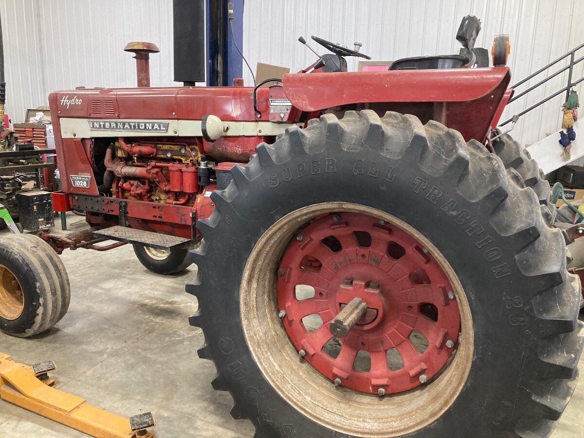

nate Posted March 25 Author Share Posted March 25 The old girl is ready for work now. It will get 2-3 set of wheel weights as soon as they melt out of the snow bank. And may get a canopy if we can find a top. We have the roll bar already. 8 Quote Link to comment Share on other sites More sharing options...
