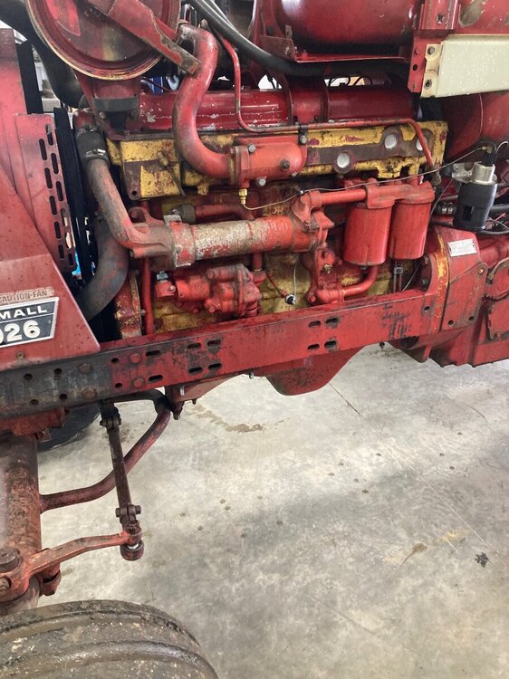

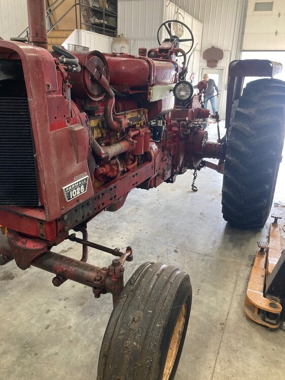

nate Posted March 5 Share Posted March 5 Well, there’s a large frame hydro back on the farm now. We used to have a 186 15-20 years ago. Dad picked up a 1026 a week or two ago. Now we are fixing things a 50 plus year old tractor needs and making it how we want it. 19 Quote Link to comment Share on other sites More sharing options...

nate Posted March 5 Author Share Posted March 5 Cab is a Cozy Cab, was made west of us in Litchfield MN. No the cab is not going back on. We think this tractor was sold new with no fenders because the ones on it are early 06 ones with only one grab hand and the paint mark on the rear light and how the wiring harness is for the rear section. Pressure washed and fixed wiring. 6 Quote Link to comment Share on other sites More sharing options...

red_reaper Posted March 5 Share Posted March 5 Don't forget, you have to check the hyd oil in the trans on this tractor while it's running! it takes a lot more hyd oil than gear drives. Great tractors! I'd ditch those side tank lights, get the correct panels without holes and put the fender lights in it if it were mine. Makes them look a lot better. 3 Quote Link to comment Share on other sites More sharing options...
Farmall1066 Posted March 6 Share Posted March 6 I believe the large lights by the fuel tank indicates fender delete. I could be wrong, but pretty sure that is from a reliable source to the south! Darn nice looking 1026! Where did your dad find that? Quote Link to comment Share on other sites More sharing options...
560DT Posted March 6 Share Posted March 6 i see an original looking muffler there nice find Quote Link to comment Share on other sites More sharing options...
brewcrew Posted March 6 Share Posted March 6 1 hour ago, Farmall1066 said: I believe the large lights by the fuel tank indicates fender delete. I could be wrong, but pretty sure that is from a reliable source to the south! Darn nice looking 1026! Where did your dad find that? Yes those lights were used when not equipped with fenders, or the clamshell fenders without lights. I’ve even seen them on tractors as new as a pair of 686 tractors! Quote Link to comment Share on other sites More sharing options...
Dan Robinson Posted March 6 Share Posted March 6 Yes, factory fender delete tractor! It has the correct curved rear field light, and side hood lights. Nice looking original! Quote Link to comment Share on other sites More sharing options...
Jacka Posted March 6 Share Posted March 6 I like those side lights,put fender lights in and keep'em. 1 Quote Link to comment Share on other sites More sharing options...

nate Posted March 7 Author Share Posted March 7 On 3/5/2023 at 2:54 PM, red_reaper said: Don't forget, you have to check the hyd oil in the trans on this tractor while it's running! it takes a lot more hyd oil than gear drives. Great tractors! I'd ditch those side tank lights, get the correct panels without holes and put the fender lights in it if it were mine. Makes them look a lot better. Yep, we have 3 other IH hydro tractors on the farm. It’s probably going to keep the side lights for now and add the fender lights 23 hours ago, Farmall1066 said: I believe the large lights by the fuel tank indicates fender delete. I could be wrong, but pretty sure that is from a reliable source to the south! Darn nice looking 1026! Where did your dad find that? I think they came with the ice cream box cans as well. It came from MN Dakota border. 22 hours ago, 560DT said: i see an original looking muffler there nice find Good eye. It is an IH muffler. Thanks for all the kind comments. It’s a good fit with the rest of our 56 series tractors. 2 Quote Link to comment Share on other sites More sharing options...

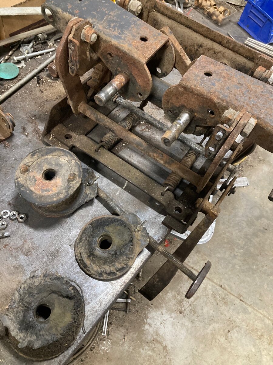

nate Posted March 7 Author Share Posted March 7 Went through the seat suspension, freed up the adjustable links that were packed with mud, going through tilt wheel. , new pivot bushing in wide front, will get anew seat eventually. 5 Quote Link to comment Share on other sites More sharing options...
stronger800 Posted March 7 Share Posted March 7 I have not noticed spindles that protrude above the steering arms like that before? Given, I’m not sure that I would’ve noticed anyway, I just know we’ve not had any like that here, but I’ve never had a 1026 either. Quote Link to comment Share on other sites More sharing options...
nate Posted March 7 Author Share Posted March 7 5 minutes ago, stronger800 said: I have not noticed spindles that protrude above the steering arms like that before? Given, I’m not sure that I would’ve noticed anyway, I just know we’ve not had any like that here, but I’ve never had a 1026 either. It is a wide front from 560 or similar we think. It will get swapped out if we find the correct one reasonably. Quote Link to comment Share on other sites More sharing options...
Dan Robinson Posted March 7 Share Posted March 7 1 hour ago, nate said: I think they came with the ice cream box cans as well. It came from MN Dakota border. Yes they did. But I believe you couldn't get a ICB on a 1026, and the rear work light was bolted to the cab. The rear light bracket on yours is fender delete only. Keep up the good progress! 2 Quote Link to comment Share on other sites More sharing options...

red_reaper Posted March 8 Share Posted March 8 It is in fact a factory fender delete tractor! As mentioned above, the rear light bracket is correct, and you can see the missing paint on the side of the light bracket where the flashing warning light bracket bolted onto it. I always wondered what platform they used for non fender tractors. Cool ! 1 Quote Link to comment Share on other sites More sharing options...
