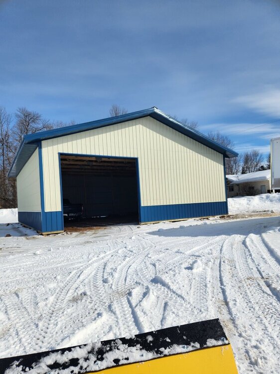

twood1954 Posted March 19 Author Share Posted March 19 Last update for a while. Now to wait for the ground to thaw. 8 1 Quote Link to comment Share on other sites More sharing options...
supermechanic Posted March 19 Share Posted March 19 How do you get soffits, you have no tails on the trusses? Got any close-up photos? I have similar trusses, and want to build a shop also. Quote Link to comment Share on other sites More sharing options...
Alan Dinan Posted March 19 Share Posted March 19 It looks great!! That’s about the same thing that I’m going with on mine. It’s still a ways down the road yet. Quote Link to comment Share on other sites More sharing options...
twood1954 Posted March 19 Author Share Posted March 19 Sorry I didn't think to take pictures of soffits. I see if I can see how they did it. Quote Link to comment Share on other sites More sharing options...

hardtail Posted March 19 Share Posted March 19 5 hours ago, twood1954 said: Sorry I didn't think to take pictures of soffits. I see if I can see how they did it. I'm thinking they must have nailed boards along the top edge of your trusses to extend that line, I'd be interested to see if they did anything extra between the trusses Quote Link to comment Share on other sites More sharing options...
hillman Posted March 19 Share Posted March 19 11 hours ago, supermechanic said: How do you get soffits, you have no tails on the trusses? Got any close-up photos? I have similar trusses, and want to build a shop also. I was wondering the same thing, maybe trusses are cheaper adding like that but theres more work to it Just noticing differences TWOOD..its a really nice building and every area seems to construct them differently. Up here you are required to put cement under the posts or bottom. so they dig trenches and pour like a footing. a PITA Are your post 3"x6" or 4"x6"? once again up here 6x6" posts. just seeing differences so don't think we are piling on Quote Link to comment Share on other sites More sharing options...
twood1954 Posted March 19 Author Share Posted March 19 I try to answer the questions. As far as drainage. The building about 2 feet higher that surrounding area. When we graded the pad last fall, we put 12 inches of gravel under building and then tapered the gravel down to 6 inch 10 feet out. I am on sandy clay with is very good drainage. I work for construction company that builds roads, so we used 25-ton pneumatic roller to compact the soil and gravel. I tested the compaction to make sure we had no soft spots. I one advantage of working there. The posts are seat on concrete pads with the pad tops being 5 foot deep. The posts are laminated post 6x6 they are 6 feet on center. They are made with same method of making laminated beam with bottom 8 feet plus being pressure treated. The design exceeds the local zoning requirements. I hope this helps. 3 1 Quote Link to comment Share on other sites More sharing options...
