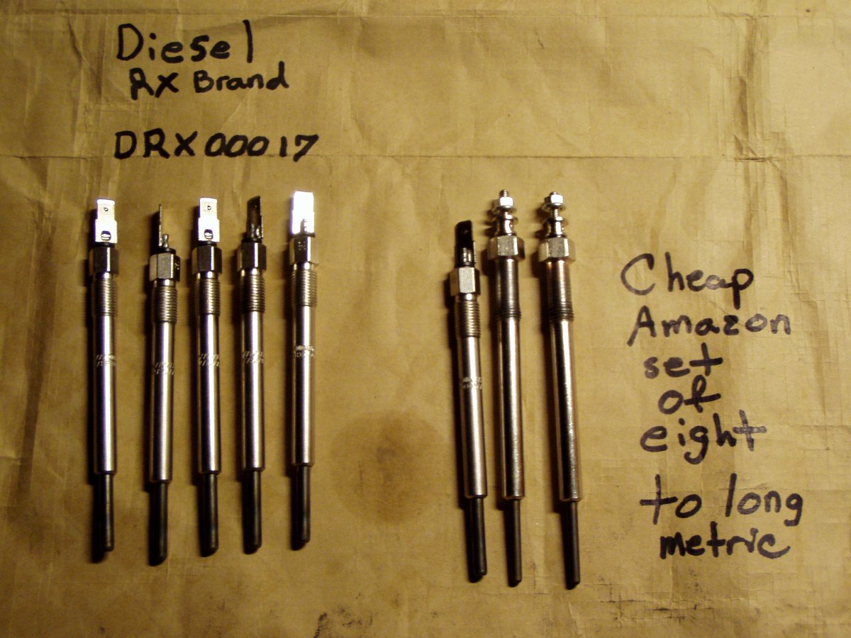

886 dreaming Posted February 4 Share Posted February 4 Last year put in a set of DRX 00017 glow plugs,started tractor one time.2nd time will not start all six plugs burned out. old plugs put back in 5 out 6 good plugs tractor starts. I also use a relay. This winter down to 3 good plugs and a bad block heater. DRX plugs for the 282 are not cheap thought a controller would help.The new drx plugs have not been used yet. I am using 6 of the cheaper amazon plugs have 2 spares, I like how the trator starts so far working good. Replaced the block heater 600 watt a&i brand claims usa made. Bad rite out of the box Quote Link to comment Share on other sites More sharing options...

886 dreaming Posted February 5 Share Posted February 5 I am sure i kept the plugs on to long even after tractor started, cold day. Alternator puts out 14+ volts Quote Link to comment Share on other sites More sharing options...
