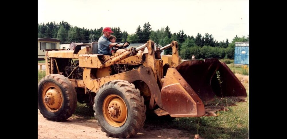

It is an HH, I have 2 of them. I picked this one up a few years ago because it was almost identical to the HH my father had and sold in 1991 when i was only 2. Unfortunately the JXD was pulled out and a QXLD and a torque converter from an HF were put in. It doesnt have quite the power the JXD would have but it works pretty good. My father had the JXD in his but they snapped the crank and swapped it with a 6 cylinder IH engine.

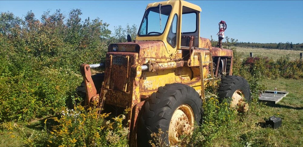

My other HH is the only my father had, I bought it back in 2021, unfortunaly most of the tin work was replaced, the engine and torque converter were swapped out for a 302 V8 and a 4 speed, which had seized up. I pulled them both inside our rink and rebuilt the better of the two over the summer of 2021 and now my dads machine is just a parts unit, but will never be scrapped as long as im alive anyways.
