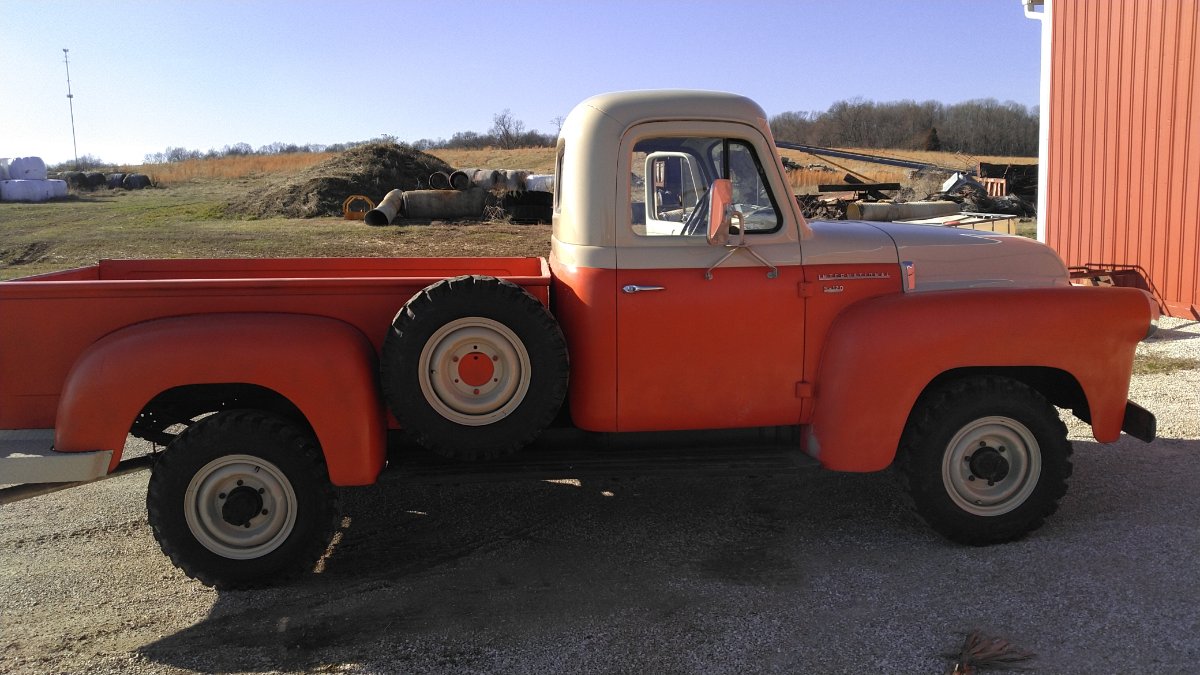

hickory Posted January 25 Share Posted January 25 I am looking for the part number for a distributor cap for my BD 240 engine. I am wanting a better quality than the local parts stores have. Any help would be appreciated. Thank; Hickory Quote Link to comment Share on other sites More sharing options...

DWF Posted January 26 Share Posted January 26 Really a good looking truck! DWF Quote Link to comment Share on other sites More sharing options...
