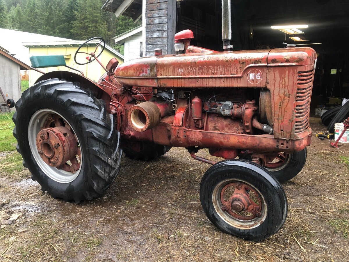

Tire day today. Had a tire for the baler I needed to replace on the shop floor and two tires for the front of the W-6. I didn’t like how the 5.50 tires looked so I put 6.50-16s on.
That looks right and they should carry better.  I’m glad I did it because both sides had clamps that I didn’t realize were loose.
Replaced the steering wheel also. The old one didn’t want to come off.
So it got cut off and the hub sliced into three pieces.
That’s better, the new one is much thicker so should be easier to grip.

Nice update Matt. Changed a steering wheel on a WD 45 once, it was stuck pretty good but apparently not as good as yours! Just heated mine with the torch and a 3-leg puller got it off the shaft.

Cutting it with a skinny wheel seemed quicker and I wasn’t trying to save it so “off with its head!”
