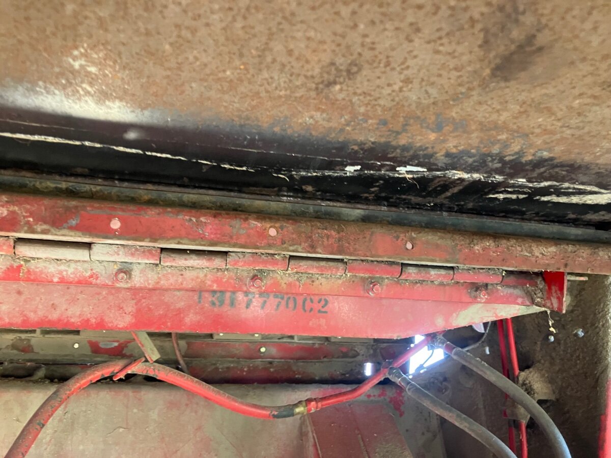

DT Fan Posted September 18 Share Posted September 18 The door on the bottom of the feederhouse on the combine. Mine is in questionable(?) shape. Went to the yard today and found a pretty good one. Was not easy to remove! Boltheads were worn completely off, cut the screws with a putty knife and hammer. Here is a picture of the 'new' parts. I will add one or two of what is on the machine now when I get them removed. This is the reason I cuss previous owners so much! Goes along with my comment about people refusing to go to town to get parts in Lorenzo's thread. 1 Quote Link to comment Share on other sites More sharing options...

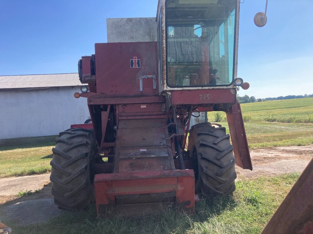

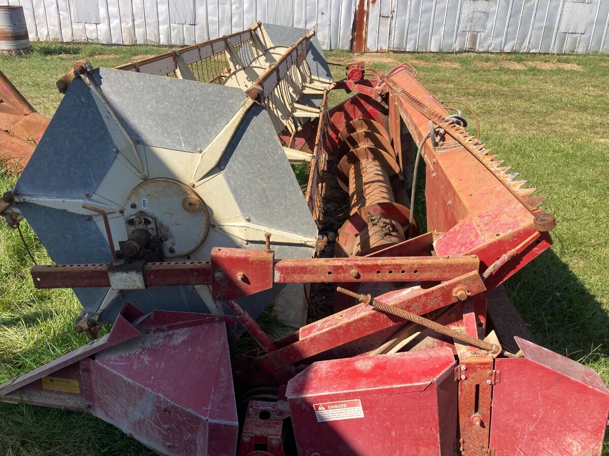

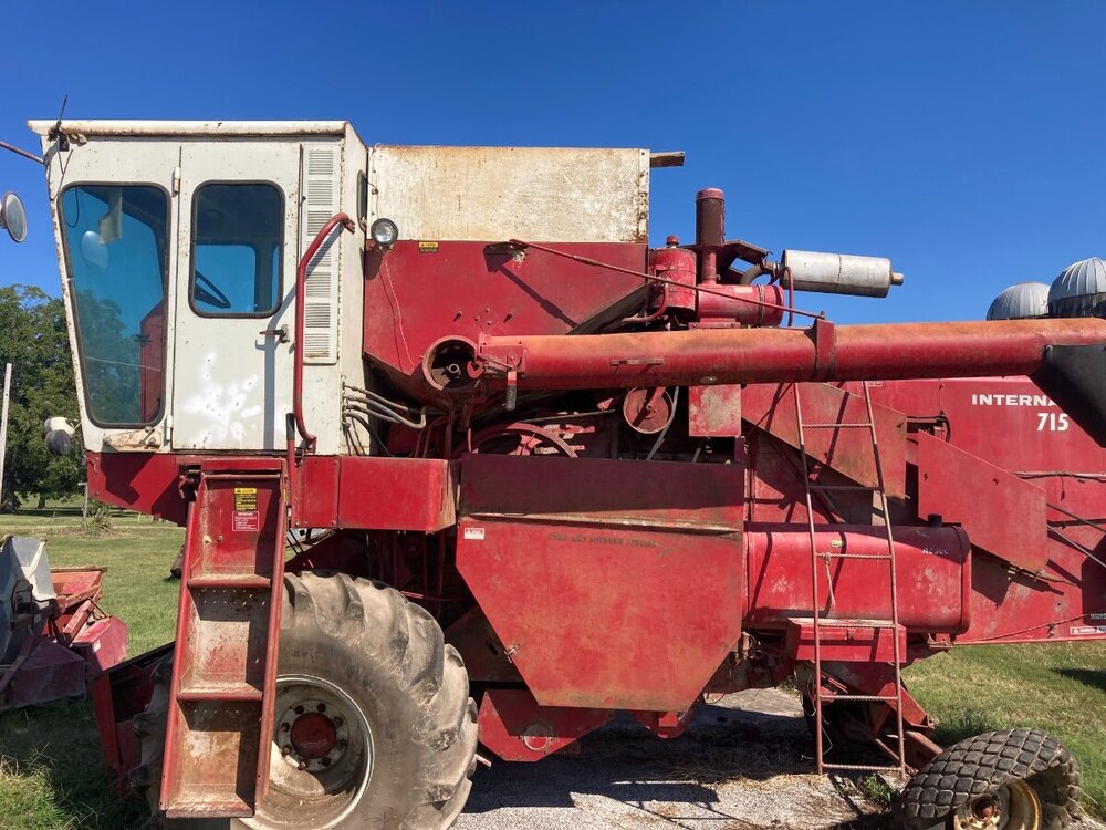

Alan Dinan Posted September 18 Share Posted September 18 Didn’t mess with trying to start the combine this morning, guy that brought a skid loader to load the headers, hadn’t slept in about 36 hours. He was in a hurry to find his bed. We pulled it on the detach and loaded both heads in about an hour. 10 Quote Link to comment Share on other sites More sharing options...
Cool1566 Posted September 18 Share Posted September 18 That’s cool! I was never around a 715 but that appears to be a very nice one. 1 Quote Link to comment Share on other sites More sharing options...
Alan Dinan Posted September 18 Share Posted September 18 16 minutes ago, Cool1566 said: That’s cool! I was never around a 715 but that appears to be a very nice one. First one for me, I grew up in a 1460 2 Quote Link to comment Share on other sites More sharing options...
DT Fan Posted September 18 Share Posted September 18 Got the 'seal' changed on the bottom of the feeder-house today. Couple more pics of what the previous owner rigged up and one installed. 1 Quote Link to comment Share on other sites More sharing options...
IHandJDman Posted September 18 Share Posted September 18 On 9/15/2023 at 9:47 PM, Alan Dinan said: Bought this 715 with both heads. 1232 hours, corn and soybean special, AC, hydro, and diesel. 810 platform 844 corn head. It has been sitting in the shed since 1990 and hasn’t been started in that time. Taking some new batteries and fresh fuel and filters. Hopefully it will fire 🤞🏻And get it loaded onto the detach. My Grandpa had the same combine except it was a gas, but it was a hydro. 1 Quote Link to comment Share on other sites More sharing options...
Alan Dinan Posted September 19 Share Posted September 19 They advertised it as a hydro but it isn’t Quote Link to comment Share on other sites More sharing options...

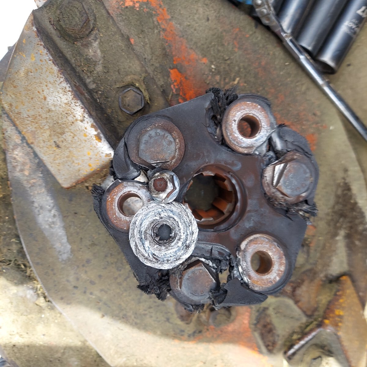

iowaboy1965 Posted September 23 Share Posted September 23 Crimping rolls spiny spiny but cutters not so much. 1 1 3 Quote Link to comment Share on other sites More sharing options...
iowaboy1965 Posted September 23 Share Posted September 23 I'm guessing either the 3 eared star or the shaft that goes thru it are stripped. Star turns but shaft doesn't and vice versa. It won't lift off tho so I'm not sure what is going on there yet. Maybe I got lucky and shaft just dropped down and out of the splines after the center bolt broke. But my luck doesn't usually run that way. Quote Link to comment Share on other sites More sharing options...
bitty Posted September 23 Share Posted September 23 5 hours ago, iowaboy1965 said: Crimping rolls spiny spiny but cutters not so much. 415 or 411? We had a 415. Was a pretty good machine but it broke the shaft that went to the cutter bar 3 times (lots of acres). Other than that it was bullet proof . Third time we traded it on a new 1431 ..... you couldn't give me a 1431 after that machine Quote Link to comment Share on other sites More sharing options...
iowaboy1965 Posted September 23 Share Posted September 23 16 minutes ago, bitty said: 415 or 411? We had a 415. Was a pretty good machine but it broke the shaft that went to the cutter bar 3 times (lots of acres). Other than that it was bullet proof . Third time we traded it on a new 1431 ..... you couldn't give me a 1431 after that machine 411. Bought it for not much a few years ago. It's been ran over a lot of acres. It does a nice job. I spent nearly as much in parts the 2nd year I had it as I gave for it. I think the disc mower Dr has what I need possibly. I used the bolts that went thru the flex joint as Jack bolts and got the 3 eared star up a 1 1/2 or so. It appears it goes down thru the bearing. The parts break down I found doesn't make it look that way. Not sure but what I might be better off taking the bottom end apart and pulling what ever will come and then try to get the top the rest of the way apart. Need to do some more research I guess. Quote Link to comment Share on other sites More sharing options...
bitty Posted September 23 Share Posted September 23 7 minutes ago, iowaboy1965 said: 411. Bought it for not much a few years ago. It's been ran over a lot of acres. It does a nice job. I spent nearly as much in parts the 2nd year I had it as I gave for it. I think the disc mower Dr has what I need possibly. I used the bolts that went thru the flex joint as Jack bolts and got the 3 eared star up a 1 1/2 or so. It appears it goes down thru the bearing. The parts break down I found doesn't make it look that way. Not sure but what I might be better off taking the bottom end apart and pulling what ever will come and then try to get the top the rest of the way apart. Need to do some more research I guess. We had taken it to the dealer we got it at and they fixed it the first two times, third time they sold the new mower to us Quote Link to comment Share on other sites More sharing options...
iowaboy1965 Posted September 24 Share Posted September 24 27 minutes ago, bitty said: We had taken it to the dealer we got it at and they fixed it the first two times, third time they sold the new mower to us It's not terrible to drop the cutter bar down and get to the parts. The first year I ran it, machine made a terrible racket. Old boy I got it from said it was pretty noisy from new and the dealer couldn't make it any better. So I ignored it. Turned out a sealed bearing on the far tower was going bad. While I had it tore down I found a suspect bearing on one of the pods so replaced 2 or 3 bearings. 1 was aftermarket at rest was dealer. That's when I spent almost as much as I gave for it. That probably started the demise of the flex coupler on the other end looking back. But it ran for several more years before coupler shaft whatever gave clear up. But I'm only doing a few acres too. Quote Link to comment Share on other sites More sharing options...
