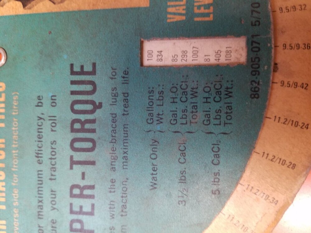

nepoweshiekfarmalls Posted January 24 Share Posted January 24 Here is the old Firestone calcium chart. Adjusted to 18.4-34. 2 Quote Link to comment Share on other sites More sharing options...
