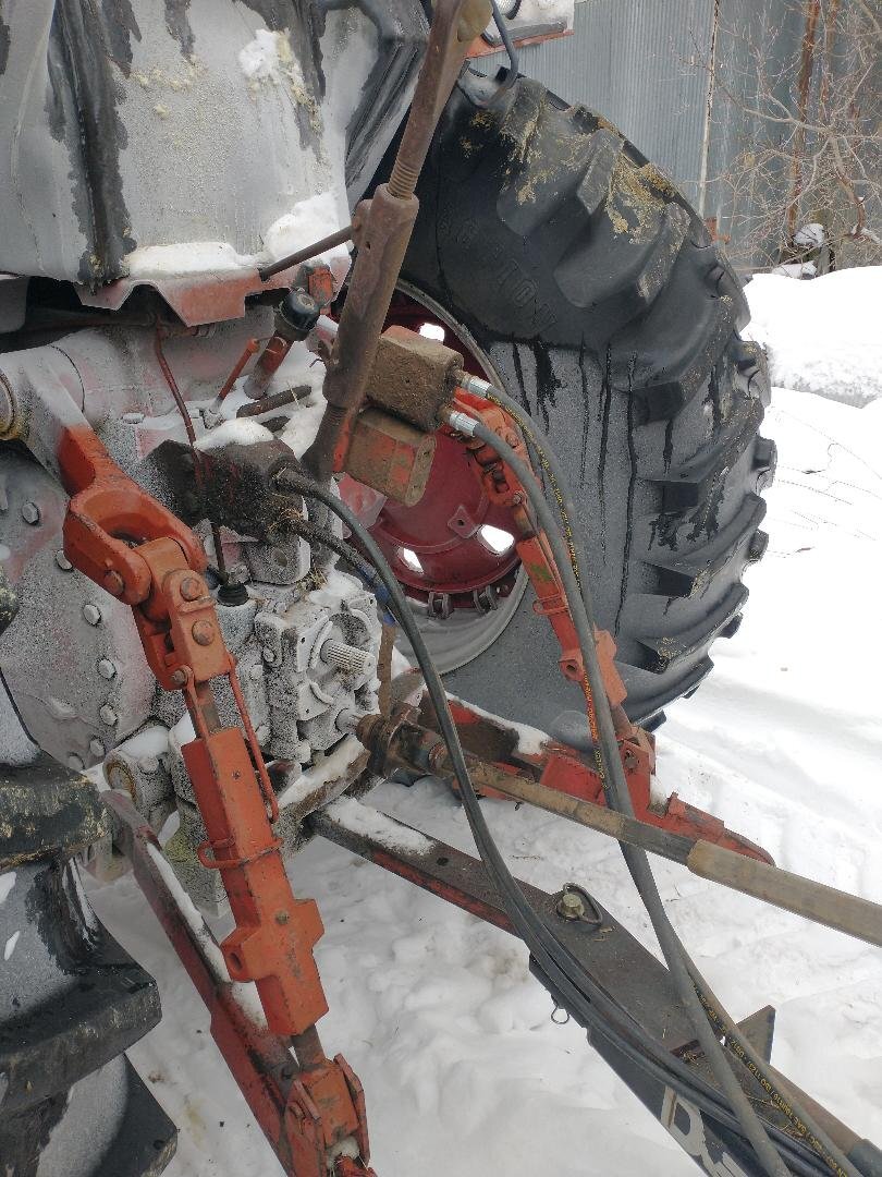

sandhiller Posted January 23 Author Share Posted January 23 20 minutes ago, db1486 said: If you can get away with a spear instead of the bucket and grapple that will make a huge difference. You wouldn't believe how much easier you will get around with the bale 2 feet closer and with a spear that weighs next to nothing compared to the bucket and grapple. Fluid and tire chains are kinda the norm on 2wd chore tractors around here. Although most are running bi-di's or fwa Your other option is put a loader on the 1486. If it's like ours there is not much that will stop that unit lol. We never ran chains on the 14 at all and kept the duals on most winters and it would go about anywhere here. 766 with fluid but on 34's would spin all the time and not go through near as much snow Ice is definitely no fun to deal with and work on. I'm glad we get to deal with snow more than ice around here I have a Dual 3100 that came with the 14 when I bought it but never put it on. It would be pretty hard getting in and around the corrals like I need to do. The 656 or SM work really well size wise. The 14 is also pulling the processor every day. I am slipping around with it too. It really needs chains too but not sure I have enough room between tire and fender and steps. Steps might be bent back towards the tires and need to see if I can move the away some. George said the tires were loaded and from this pic I am guessing this is the line. 1 Quote Link to comment Share on other sites More sharing options...
Gearclash Posted January 23 Share Posted January 23 Yah no guessing there -- that tire is loaded and to that level! I bought a tractor once that had about 1/4 of a rear tire filled with plain water. Hadn’t a clue until I used it after the first good freeze. Lurch hop lurch hop . . . hmmmm. 1 Quote Link to comment Share on other sites More sharing options...
