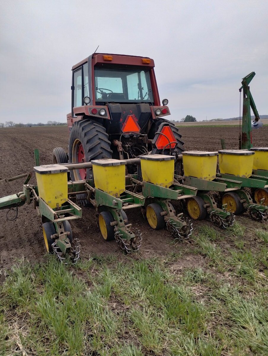

2+2love Posted April 29 Author Share Posted April 29 So this i what i ended up with. Found a 7300 john deere vacuum planter. Replaced everything and switched a lot from my old planter. All together i have about $8,000 in to it. So im running it on my 3488 hydro. Perfect set up for my smaller fields. I have been eliminating head lands most of them are 30 to 40 feet so not much turn around space. I was able to plant some organic soybeans with it yesterday. Everything worked very good after getting things adjusted. The 3488 is a perfect tractor. I also added 9.5x24 tires on the front and i think i like it. So i will have to paint the rims silver. Quote Link to comment Share on other sites More sharing options...
