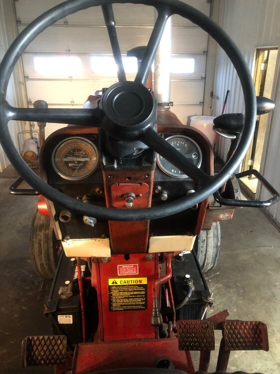

Red Flyer Posted January 3 Share Posted January 3 I am trying to find out if there is a cross reference for light bulb part number 9412348. When I do a search on line it also comes up as a GM and Volvo part. Is there a different number I could use if I went to NAPA? Also are there tinted ones as well? APF Quote Link to comment Share on other sites More sharing options...

stronger800 Posted January 4 Share Posted January 4 You can buy those bulbs at Walmart, or anywhere, they’re probably one of the most common small automotive push and twist bulbs from since forever. Several variations of brightness and size, with minimal to no noticeable difference, as they would all plug-in and illuminate the gauges just fine. Any bulb that looks like this: Quote Link to comment Share on other sites More sharing options...
stronger800 Posted January 4 Share Posted January 4 I just replaced them in an 806. Didn’t even have to open a new box, I found enough of them rolling around in the top of my toolbox drawer separately . Crappy picture though. 2 Quote Link to comment Share on other sites More sharing options...
Jeff-C-IL Posted January 4 Share Posted January 4 I bought LED replacements off Amazon for those on my 666 - same base, very similar lens top, work great. No more burned out indicator bulbs. Quote Link to comment Share on other sites More sharing options...

François02 Posted January 30 Share Posted January 30 I am looking to replace my light bulbs on my 756 and there is 2 references, but the bulbs socket look similar the ref #9417863 is replaced by #214045 (7.15€ here) the ref #9412348 is replaced by #A14553 (1.95€) I find some LEDs on ebay, like this offer but I am not sure it will fit Quote Link to comment Share on other sites More sharing options...
IHC_1470 Posted January 30 Share Posted January 30 Both bulbs use the same base as I remember. They are both the same wattage at 3.78. The 1895 is probably a panel light and would be on all the time. The 257 is a flashing bulb IH used for oil and amp. They flashed to help get your attention. Most auto parts stores here in the US will carry the 1895 the other may be a little harder to get but should still be available. NAPA which is an auto parts store here list the 257 for $4.19 US dollar. Quote Link to comment Share on other sites More sharing options...
François02 Posted January 31 Share Posted January 31 12 hours ago, IHC_1470 said: Both bulbs use the same base as I remember. They are both the same wattage at 3.78. The 1895 is probably a panel light and would be on all the time. The 257 is a flashing bulb IH used for oil and amp. They flashed to help get your attention. Most auto parts stores here in the US will carry the 1895 the other may be a little harder to get but should still be available. NAPA which is an auto parts store here list the 257 for $4.19 US dollar. so, do you think I can order the same all bulbs? Quote Link to comment Share on other sites More sharing options...
IHC_1470 Posted January 31 Share Posted January 31 If you do not care if the oil and amp light do not flash when lit up then yes the 1895 bulb should work just fine. Quote Link to comment Share on other sites More sharing options...
