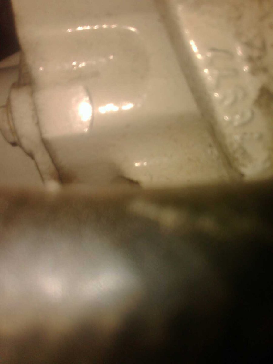

FarmerFixEmUp Posted December 31, 2022 Share Posted December 31, 2022 A customer of mine has a Kohler generator with a John Deere 4 cylinder diesel engine. It has a water pump leaking badly. I’ve been talking to a repair shop more up on Deere about a replacement water pump and he says John Deere told him it can have 5 possible water pumps. He asked for a casting number off the pump, so I took the shielding off around the fan and the alternator off and it’s very difficult to read anything without taking the pump off itself. I have some pictures of the engine ID tags. Would anyone have an idea what it would need? He doesn’t really want it taken apart without the part to get it going in case of power outage but I really don’t know what else to do. The pictures of the numbers on the water pump are difficult to read. Sometimes I just need to say no thanks. Quote Link to comment Share on other sites More sharing options...
Ian Beale Posted January 1 Share Posted January 1 Try outlining around them with a fine black sharpie pen and a steady hand? Then, if you can get a list of those 5 numbers, see what goes close to matching what you divine. Quote Link to comment Share on other sites More sharing options...
FarmerFixEmUp Posted January 1 Author Share Posted January 1 All 3 of those numbers look different to me so not sure what to expect. There's numbers behind the pressed on drive pulley as well! Quote Link to comment Share on other sites More sharing options...

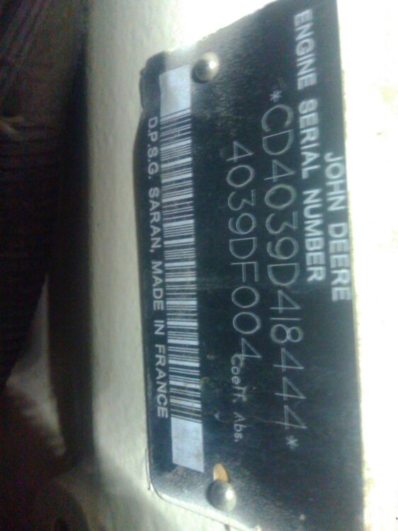

mjcolemn Posted January 1 Share Posted January 1 I looked it up on jdparts.com, it showed 2 options RE58910 marked with # R67188 or AR97708 marked # R73604 Both take RE62658 rebuild kit. 1 Quote Link to comment Share on other sites More sharing options...
cedar farm Posted January 1 Share Posted January 1 It looks like the 4039 engine actually used 12 different water pumps. Stupid. The good news is A & I has 7 of them on hand. They also give the casting info. The pumps thay have are AR77142, RE24760, AR97717, AR97708, RE25043, RE16666 and RE43141. Quote Link to comment Share on other sites More sharing options...
Dirt_Floor_Poor Posted January 1 Share Posted January 1 When I look up that serial number I only see two different style pumps that come up. It looks like the difference is how many ports are on the pump. One pump style shows a serial number break and one does not. This advice is worth what it costs. Quote Link to comment Share on other sites More sharing options...
FarmerFixEmUp Posted January 1 Author Share Posted January 1 1 hour ago, cedar farm said: It looks like the 4039 engine actually used 12 different water pumps. Stupid. The good news is A & I has 7 of them on hand. They also give the casting info. The pumps thay have are AR77142, RE24760, AR97717, AR97708, RE25043, RE16666 and RE43141. I've been talking to Bill at H&H and he told me he sees about a 70% leakage rate within 200 hours on A&I water pumps. It looks a lot like the Ar97708, has the 2 pipe ports on the bottom at an angle. https://partscatalog.deere.com/jdrc/sidebyside/equipment/82706/referrer/navigation/pgId/13066809 Same part number here but the pipes are too close together, unless the picture is just a sample. https://www.abilenemachine.com/water-pump-amar97708?CATARGETID=120054580000018712&CAPCID=569389714689&CATCI=aud-904053054712:dsa-61348327156&CAAGID=132340173738&CADevice=c&gclid=EAIaIQobChMI-_Dun6el_AIVBa_ICh1wKAHeEAAYASAAEgJzsvD_BwE Quote Link to comment Share on other sites More sharing options...
JDpartsman Posted January 1 Share Posted January 1 A good dealer can go in and do an engine option code search for that specific serial number and narrow it down to 1 waterpump. I don't know if I can look it up at home here, but I can try. 2 Quote Link to comment Share on other sites More sharing options...

MarkG Posted January 1 Share Posted January 1 Some times the jd engine serial number will not show up for jd dealers if the engine powers another manufacturers equipment. They want you to go back to Koehler to get the parts. Quote Link to comment Share on other sites More sharing options...
yellowrosefarm Posted January 1 Share Posted January 1 The tag on the valve cover with the codes should give the dealer what they need to tell which water pump is used. A dealer that sells construction equipment is usually more familiar with this than a lawn and garden or straight ag dealer. Quote Link to comment Share on other sites More sharing options...
