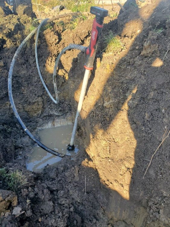

Cliff Neubauer Posted November 10, 2022 Share Posted November 10, 2022 Good to know that it will work for oil. I bought the M12 Stick pump last spring and it works slick for pumping water out of holes for fixing water or tile lines. 1 Quote Link to comment Share on other sites More sharing options...
