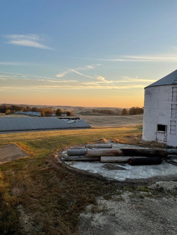

zleinenbach Posted October 23, 2022 Author Share Posted October 23, 2022 Here’s some updates, pad getting filled up, See through panels installed and all motors framed up, electric panels demoed and new installed fiber conduit for when that comes around here, hoping next two years. stainless pipe is antenna mount for security cameras 5 Quote Link to comment Share on other sites More sharing options...
vtfireman85 Posted October 23, 2022 Share Posted October 23, 2022 Whats all the control equipment, I understand you have fans, lights and probably adjustable ventilation, that looks like a lot of wires for turkeys. Quote Link to comment Share on other sites More sharing options...
zleinenbach Posted October 23, 2022 Author Share Posted October 23, 2022 26 minutes ago, vtfireman85 said: Whats all the control equipment, I understand you have fans, lights and probably adjustable ventilation, that looks like a lot of wires for turkeys. The old ones were for stir fans and exhaust fans, if I counted right is was 20 fans total. Then all the temp sensors and pressure switch and vent doors 1 Quote Link to comment Share on other sites More sharing options...
vtfireman85 Posted October 23, 2022 Share Posted October 23, 2022 3 minutes ago, zleinenbach said: The old ones were for stir fans and exhaust fans, if I counted right is was 20 fans total. Then all the temp sensors and pressure switch and vent doors Re-using any of the plumbing? Or is it all toast? Your going to 3ph 480 so obviously your running new wires to everything. I believe you mentioned some corrosion issues? Going plastic this time? Quote Link to comment Share on other sites More sharing options...
zleinenbach Posted October 23, 2022 Author Share Posted October 23, 2022 27 minutes ago, vtfireman85 said: Re-using any of the plumbing? Or is it all toast? Your going to 3ph 480 so obviously your running new wires to everything. I believe you mentioned some corrosion issues? Going plastic this time? Grey gold. Previous install was EMT and set screw connectors. Less than water tight for sure. plumbing is going to be redone but isn’t that crazy to do. I am beyond ocd on the water line stuff, and it’s triggered looking at what they did lol Quote Link to comment Share on other sites More sharing options...
