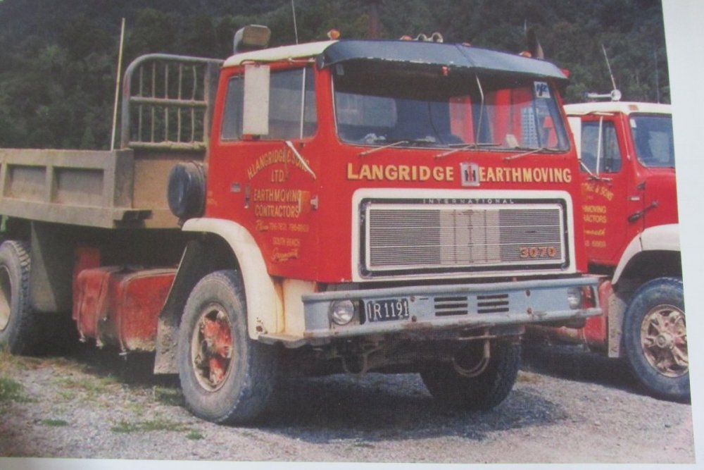

mike newman Posted September 8, 2022 Share Posted September 8, 2022 .....a lot of 903 Cummins , down under ,back in the days...very good engines Mike 1 Quote Link to comment Share on other sites More sharing options...
1066 Peterbilt Posted September 10, 2022 Share Posted September 10, 2022 In North America they seemed to go one way of the other. Ran a long time and were dependable. Just not a lot of power. The other way was they stayed in the shop all the time and owners got rid of them ASAP. That one must have been OK? 1 Quote Link to comment Share on other sites More sharing options...
