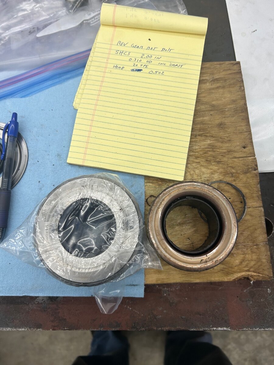

Well my first project I have been putting off is the manual tranny in my powerstroke diesel. It was a real bugger to get into 2nd gear.  Ended up buying a few tools, having some help, borrowing a few tools and tearing it apart
hmmmm.  Throw out bearings appear different
having problems with the rear seal and one of the bolts to the rear idler gear.

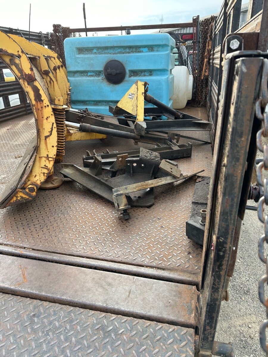

Since we have a few driveways to keep open in the winter, it’s time for a plow truck.  Well I have an old dependable work truck, and I found a Fisher plow with engine hydraulics for a good price
now I need to give her some TLC, and then figure out this puzzle
A726E55F-76B4-4D57-A1C1-2D23953AE634.thumb.jpeg.053bbf55982a46f4bf7af613c09d5c83.jpeg21E4B339-E9A4-4886-811D-17AD821BEE81.thumb.jpeg.27fa002df8c4e948b3d2888ffe64cd01.jpeg5A0A6357-5990-4DD5-990F-A1125EDF502A.thumb.jpeg.db0f27457ce018dfdad5326c7e8291a8.jpeg
anyone happen to have the bracket for a fisher pump to mount to a 7.3 idi?
On 8/18/2023 at 8:44 PM, AKwelder said:
Well I drove the truck for a few days and it appears to be as it should, also got some gauges installed in it.  Now I need to check the PCM number and order new injectors and a hydra
