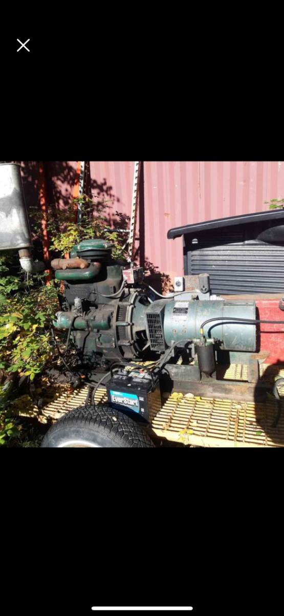

AKwelder Posted July 21, 2022 Author Share Posted July 21, 2022 Well things changed. Found a 14kw lister a buddy was selling it, hadn’t seen him in awhile. Saw it listed and called. Better size, and more of what I wanted. 3 Quote Link to comment Share on other sites More sharing options...

AKwelder Posted December 26, 2022 Author Share Posted December 26, 2022 1 hour ago, Twolines said: Thanks for the mention. We've been fortunate so far this year with only brief outages. Its been down in the -40s for almost a week now but we've had the stove rolling so good there. A friend of a friend died a couple years ago down the way from us and ive been offered a bunch of stuff from his estate. I will know more after break up..but one piece ill be taking is an old IH generator. They say its a 12kw and is gas but the pics they showed me, it looks like diesel. Ill take it either way. Theres also 2 IH track loaders and a dozer they want to push my way along with an ancient excavator? Not sure of the exact term but its all cable....drag line shovel? We havnt talked prices yet but sounds like they just really want the stuff off the property. Merry Christmas everyone! Glad your doing well. Sounds like some interesting iron, keep us posted Happy Holidays, Merry Christmas, and stay warm 1 Quote Link to comment Share on other sites More sharing options...
