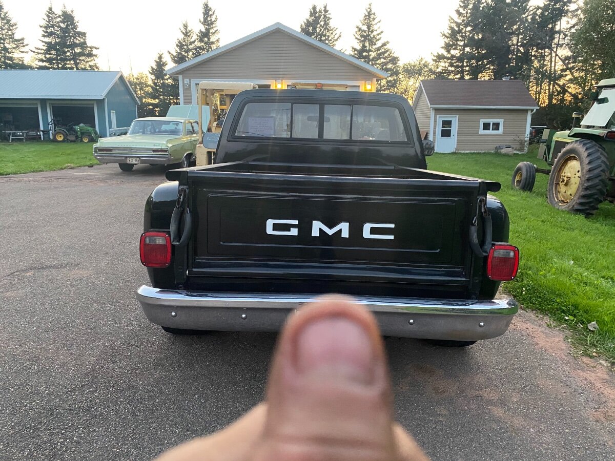

AngrySailor Posted September 26 Author Share Posted September 26 2 hours ago, Takn4aFool said: is that a Lakewood 2 piece bell housing i see there? i had one of those in a '73 Chevy Nova that i transplanted a 402 big block into. It is. I had a 73 nova, it was rough shape. Never got it on the road. That would be a fun car with a 402. got a ‘64 olds in the shop for some engine work, he’s got cam/lifter issues and wants a carb swap. He knows the 454 is for sale, maybe I should have a “miscommunication” and install it for him 😆 It’s a 394 oldsie, first pic I searched for cam up with Hilborn injection and a blower. Maybe that’s what he wanted? Cool guy but don’t think he wants that much go go sauce. slapped the GMC logo on the truck finally. Been missing since ‘97. Was hard to find back then and I can’t paint... 4 2 Quote Link to comment Share on other sites More sharing options...

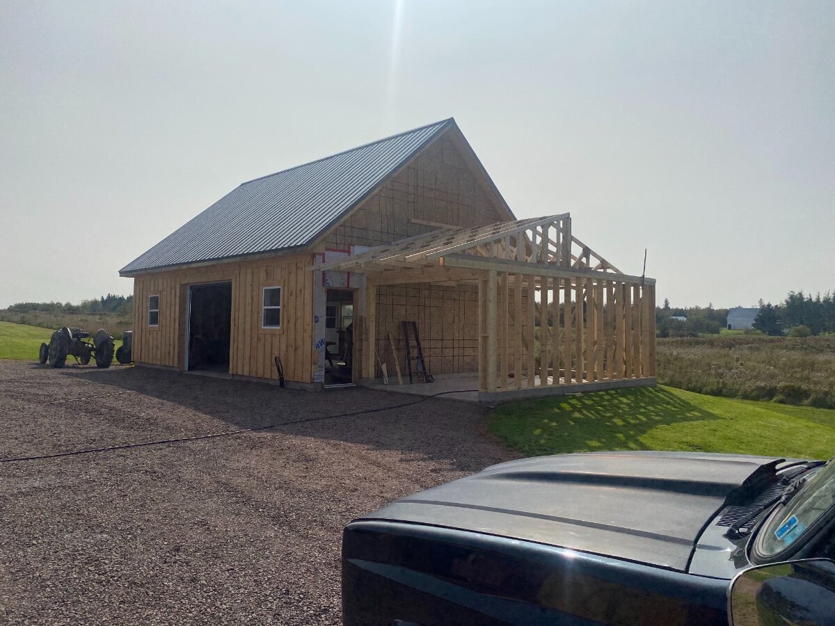

AngrySailor Posted September 30 Author Share Posted September 30 That’s exactly the issue is the oil. I run VR1 which has ZDDP even though I’m running a roller cam it helps the extreme pressure load carrying ability of the oil. So it’s some government holiday for the Indians today... must be a cruel joke cuz they closed the liquor store! stopped and seen pops for a bootleg box of Quebec beer. He’s making good progress on his building. Of course I had to leave the first Mark! 5 Quote Link to comment Share on other sites More sharing options...

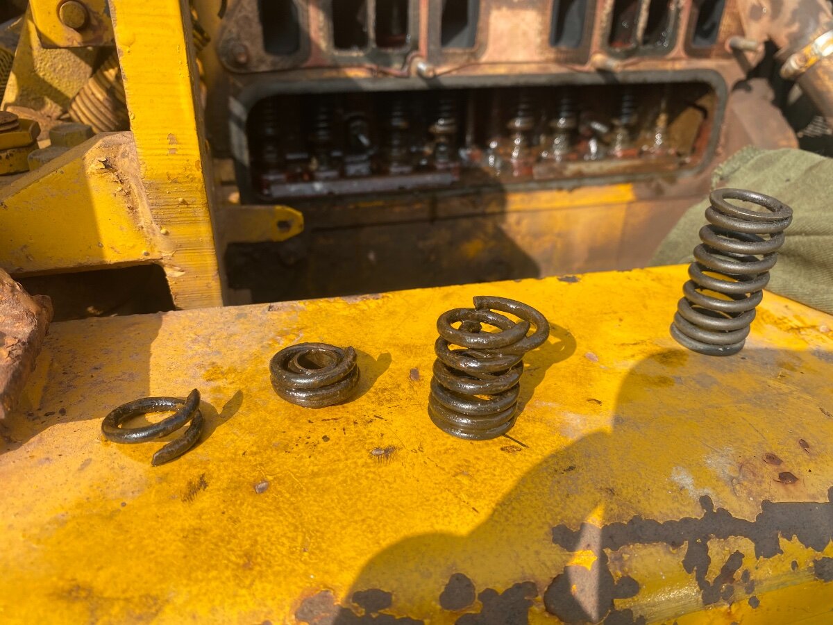

AngrySailor Posted September 30 Author Share Posted September 30 That old TOWMOTOR I worked on is back. Broke a valve spring. POS is whipped. Guides were loose and wasn’t in the budget to do them. Full of condensation so the springs rust and break. Just happen to have a replacement in stock in a Saturday so she’s getting a sling slapped in and sent down the road. Poor thing needs a full rebuild... 1 Quote Link to comment Share on other sites More sharing options...
