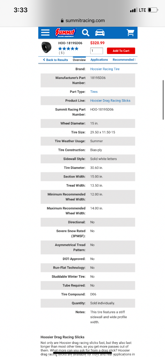

AngrySailor Posted June 20 Author Share Posted June 20 Fug it. Ordered these. They have a more square profile with a 15” section width and 13 1/2” tread width. Much more square than any others I’ve found. Stiff sidewall and a bit harder compound than the ultra soft jobbies. They’re also at the cheap end of the drag slick or any tire in this size price range. One M/T SR street radial is as much as a pair of these. I’ve used M/T E.T. Street drag slicks before and they were soft side wall, acceptable to drive but definitely soft on corners so these should be fine, kinda know what to expect and a cornering machine this is not. One problem, These are not DOT but nothing a tire groover and a red hot letter stamp can’t fix! I’ll have to tub the box and alter my back spacing to fit them how I want though. Don’t think I have to move the springs for these. Pops building coming along, got the garage door installed (himself) and the second floors sheeting down. Maybe the old fart doesn’t need my help? Oh yeah and I quit my job today. Making one more trip and leaving on good terms. Got a call from the previous company (who I never imagined would ever call back) and I must resign or return. Looking at seniority and other issues I think I had to accept the offer to return. They’re probably going to shitcan me but whatever. Might be the kick in the azz to step up my game from home, tired of being away so much. 3 Quote Link to comment Share on other sites More sharing options...
