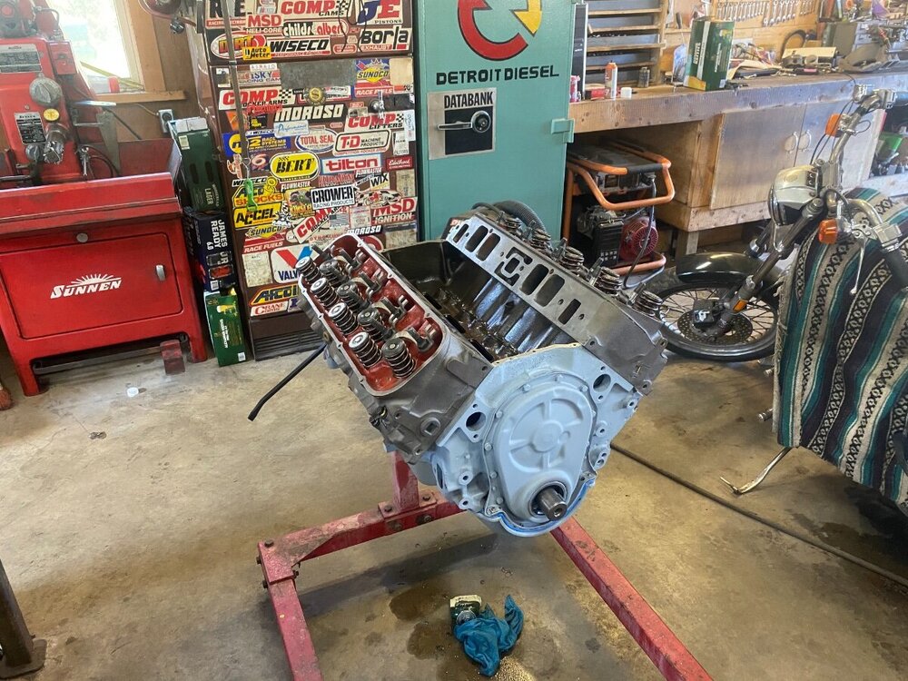

AngrySailor Posted May 18 Author Share Posted May 18 Pan on, heads on and torqued. 3 Quote Link to comment Share on other sites More sharing options...
AngrySailor Posted May 18 Author Share Posted May 18 Still gotta install the valve gear but she’s painted and mocked up about how she’s going in the truck. 4 1 Quote Link to comment Share on other sites More sharing options...

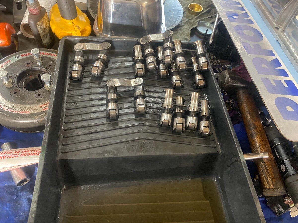

AngrySailor Posted May 19 Author Share Posted May 19 Dayum! These lifters are all pressure pin oiled. Sweet! Just gotta set the lash and bolt down the intake or “dome” as they seem to call it down east here... packing my bags today also, leave the house at 2am to catch my flight. Fug... 4 Quote Link to comment Share on other sites More sharing options...
