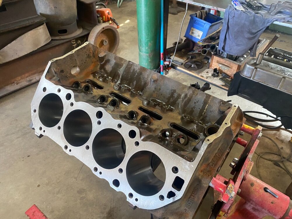

AngrySailor Posted May 11 Author Share Posted May 11 Engine brush kit I ordered didn’t come in so I’m abusing an old rifle cleaning kit... man for being ranked twice this junk yard block is still dirty. The forward oil gallery from the main to the cam journal was full of crap. Got everything scrubbed through now, about ready to pressure wash and oil it down. 5 Quote Link to comment Share on other sites More sharing options...
AngrySailor Posted May 11 Author Share Posted May 11 Washed and brushed, galley plugs in, crank washed. Bearing clearance measured... a tad loose on the rear main. It’s going together 🤪 it’ll be fine, big oil pump, thick oil. Better a tad loose than tight. 3 Quote Link to comment Share on other sites More sharing options...

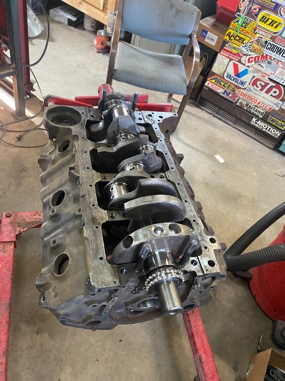

AngrySailor Posted May 11 Author Share Posted May 11 Crank in, thrust seated, even remembered the rear main seal. One rod and piston in for deck clearance check... hmmm she’s a little “spicy”... have to measure pop out, probably be milking the quench area of the pistons. 2 Quote Link to comment Share on other sites More sharing options...

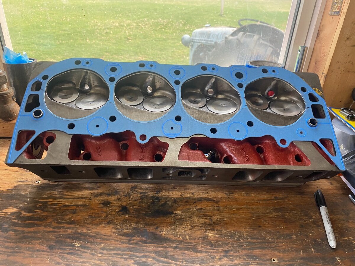

AngrySailor Posted May 12 Author Share Posted May 12 1 hour ago, Rawleigh99 said: Sailor are you using playdoh to check your quench? Measuring at the moment. Now that the pistons are milled to zero deck the piston rocks 0.012” below the deck and 0.012” above the deck. At zero deck quench will be 0.39” with the fel-pro 1027 gaskets. Probably use some just to check piston to valve quick as I don’t want to remove valve springs to put test springs on and these big blocks have lots of room at this cam and piston dome level. It’s also a bit of a known combination with this cam and head. Theres likely over 1/4” piston to valve or more but a quick check never hurts. 4 Quote Link to comment Share on other sites More sharing options...
