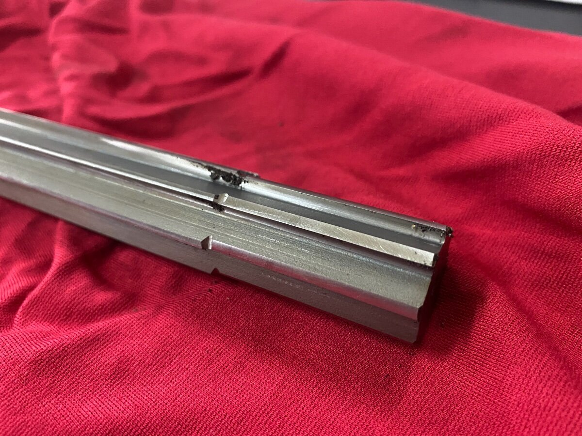

560Dennis Posted May 7 Share Posted May 7 20 hours ago, AngrySailor said: SOB! My friend called me said one of his numpties put DEF in the diesel tank of his new duramax. Asked if I’d fix it, of course I said NO! Well lookie what just got dropped off in front of my shop 🤬 Working on the 496 lifter bores. Using a custom reamer I had ground to open them to 0.903” then finish hone to 0.9055”. There’s a non cutting pilot that guides in the existing bore snug to keep things straight. This is the one with the BIG bump stick and Merlin aluminium heads. Made just shy of 800hp on the dyno. 796 I think, couldn’t quite push it over 800. This cam is a little more lift and duration and she’s getting the Hilborn injection so she should be 800+ now. Oh I bumped the compression from 10.5;1 to 11:1 too. Big big big block! Went to auction yesterday . This reamer was in the Cotton Club (Akron,Ashtabula,Cleveland ) wooden box I wanted bad,,(score ). I caliper the diameters for your edification an amusement. What’s it taper reamer used for ? He’s was Farmall Man. taper Morse 2? Don’t remember Quote Link to comment Share on other sites More sharing options...
AngrySailor Posted May 7 Author Share Posted May 7 10 minutes ago, 560Dennis said: Went to auction yesterday . This reamer was in the Cotton Club (Akron,Ashtabula,Cleveland ) wooden box I wanted bad,,(score ). I caliper the diameters for your edification an amusement. What’s it taper reamer used for ? He’s was Farmall Man. taper Morse 2? Don’t remember Looks like MT3, probably used for boring holes for tapered dowel pins and sometimes for aligning mismatched holes in two plates. nice box 1 1 Quote Link to comment Share on other sites More sharing options...

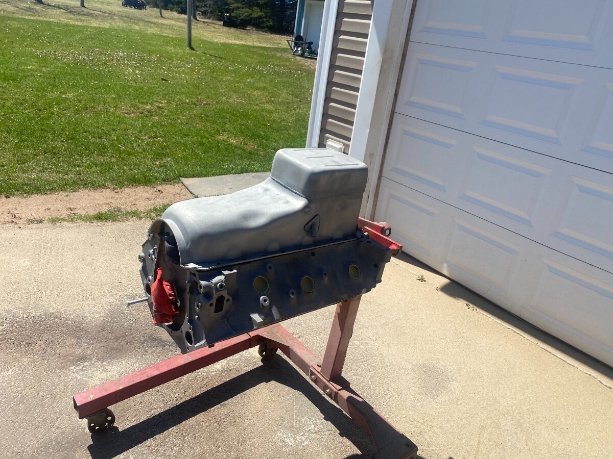

AngrySailor Posted May 7 Author Share Posted May 7 Think she’s ready to go to the shop. Still have to change rod bolts in one set, make sure I’ve got everything that needs to go packed up and good to go. I told buddy not to bring his truck here so hope he doesn’t complain if it got sand on it... 3 Quote Link to comment Share on other sites More sharing options...
hardtail Posted May 7 Share Posted May 7 Did you weld on the pan sump extension? FYI look for a 427 gravel truck pan and pump pickup, factory parts Quote Link to comment Share on other sites More sharing options...
AngrySailor Posted May 7 Author Share Posted May 7 3 minutes ago, hardtail said: Did you weld on the pan sump extension? FYI look for a 427 gravel truck pan and pump pickup, factory parts That’s a (fairly cheap) moroso pan, 9” deep and most importantly it has the bumps to clear the rod bolts with the 4.250” stroke and cap screw rods. I’ve also added some more baffling inside to keep the oil from climbing the back of the pan. She’s some dirty inside from years of sitting around though... 3 Quote Link to comment Share on other sites More sharing options...

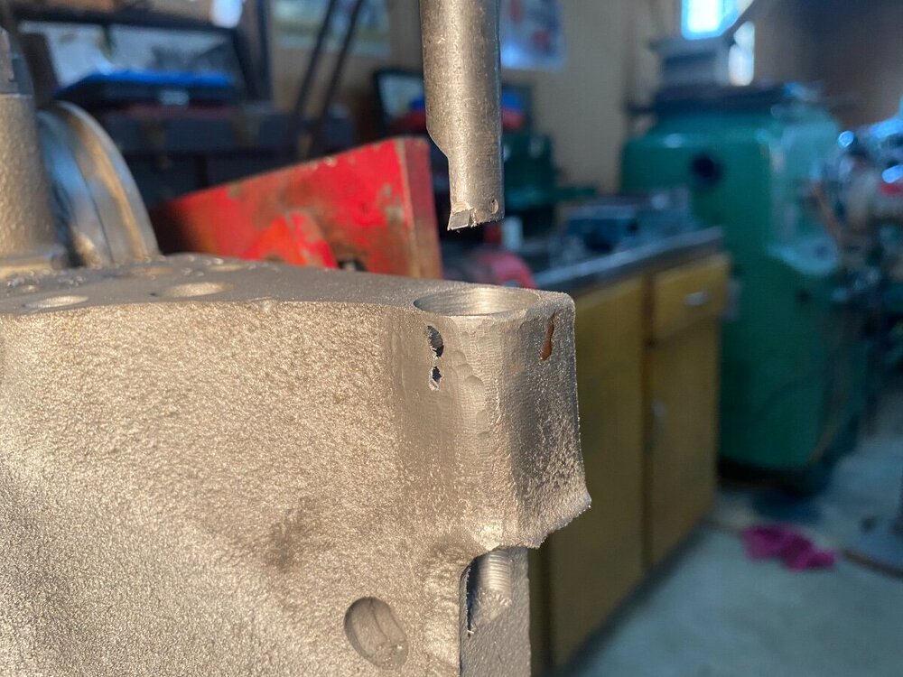

AngrySailor Posted May 7 Author Share Posted May 7 Huh forgot about this. This starter boss has been busted ever since I got this block. The helicoil is in pretty deep and it’s 7/16NC. I had a special stud made for there that stepped to 3/8”. It goes in pretty deep and never gave me an issue. I am tempted to grind away the broken part so it doesn’t propagate deeper... Quote Link to comment Share on other sites More sharing options...
AngrySailor Posted May 7 Author Share Posted May 7 Guess I’m committed now, going to counter bore the crack away and machine up a stepped, threaded insert to repair this and bring it back to 3/8”NC as it should be. They installed the sign this morning. Booked the road closed from 6am to midnight. They left the yard where we built it at 6:30 and the road was open by 9am. Fit like a glove. 6 Quote Link to comment Share on other sites More sharing options...

560Dennis Posted May 8 Share Posted May 8 16 hours ago, AngrySailor said: Guess I’m committed now, going to counter bore the crack away and machine up a stepped, threaded insert to repair this and bring it back to 3/8”NC as it should be. They installed the sign this morning. Booked the road closed from 6am to midnight. They left the yard where we built it at 6:30 and the road was open by 9am. Fit like a glove. Please photo the counter bore fix Quote Link to comment Share on other sites More sharing options...
AngrySailor Posted May 8 Author Share Posted May 8 4 hours ago, 560Dennis said: Please photo the counter bore fix Hope this works... I’m able to just clean the old threads out at 9/16-18 tap drill size. I’d like to use coarse threads but there is a fair depth of thread going to be in there when I’m done. It also will not be removed, the repair sleeve will be threaded in once then the starter bolt will thread into that. I also carried that bore down through the starter boss with the plan to cross drill 1/4” shoulder bolt through there to secure it... I’m about half inch deep on the counterbore now and I think I’ve gotten rid of all the crack. Quick and dirty magnaflux test, speaker magnet and two punches worked surprisingly well. Probably be even better with finer iron dust. 1 Quote Link to comment Share on other sites More sharing options...
AngrySailor Posted May 8 Author Share Posted May 8 Crack all gone so I’m not worried about it propagating farther. Good length of 9/16-18 thread in there. Think she’s good to go, gotta turn the repair sleeve on the lathe now. 3 Quote Link to comment Share on other sites More sharing options...
AngrySailor Posted May 8 Author Share Posted May 8 Loctite that in, cross bolt it where is comes out the bottom then drill and tap for the original 3/8 starter bolt. Going to mill it flat to the bock too of course 3 Quote Link to comment Share on other sites More sharing options...
AngrySailor Posted May 8 Author Share Posted May 8 Starter fits, seE if it holds. This block ready for bores, lifter bore hone and open up the rod/main clearance. Dropping it of tomorrow and picking up the ‘54 to assemble. 3 Quote Link to comment Share on other sites More sharing options...
AngrySailor Posted May 8 Author Share Posted May 8 Forgot that through bolt. Wish I had some grade 8 Allen heads I’d have counter bores it in some. Whatever, it’s done. 6 Quote Link to comment Share on other sites More sharing options...
