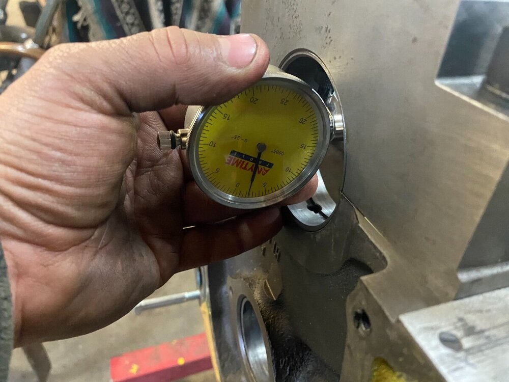

AngrySailor Posted May 6 Author Share Posted May 6 Slammed the caps on with the old bearings. Dial bore gauge set to 2.749” and IF that’s the cranks actual size I’m only reading 0.002” clearance. WAY too tight for this application... no wonder she’s trying to eat herself... 1 Quote Link to comment Share on other sites More sharing options...
560Dennis Posted May 6 Share Posted May 6 6 minutes ago, AngrySailor said: Slammed the caps on with the old bearings. Dial bore gauge set to 2.749” and IF that’s the cranks actual size I’m only reading 0.002” clearance. WAY too tight for this application... no wonder she’s trying to eat herself... Is that John Deere yellow ? how straight is that ? Align bore is needed ? Just a question! Quote Link to comment Share on other sites More sharing options...
iowaboy1965 Posted May 6 Share Posted May 6 1 hour ago, AngrySailor said: cylindricallity or however you want to call it. Concentricity? Quote Link to comment Share on other sites More sharing options...
jeeper61 Posted May 7 Share Posted May 7 2 hours ago, iowaboy1965 said: 3 hours ago, AngrySailor said: cylindricality or however you want to call it. Concentricity? Cylindricality i.e. the roundness of a cylinder is what is needed on bores by themselves Concentricity would be the positional relationship between multiple bores like all the crank bores He needs to get more clearance so align bore is needed Quote Link to comment Share on other sites More sharing options...
AngrySailor Posted May 7 Author Share Posted May 7 2 hours ago, 560Dennis said: Is that John Deere yellow ? how straight is that ? Align bore is needed ? Just a question! Think it’s cat yellow as it was in the boat, needed yellow for the “look” but never liked that yellow. It’s straight but too tight. Needs a line hone to reduce bearing crush and increase clearance. 31 minutes ago, jeeper61 said: Cylindricality i.e. the roundness of a cylinder is what is needed on bores by themselves Concentricity would be the positional relationship between multiple bores like all the crank bores He needs to get more clearance so align bore is needed That issue is with the lifter bores, the ones I tried to hone with my rig are ever so slightly “barrel” shaped. They’re not cylindrical. Buddy has the proper hone to correct that. 1 Quote Link to comment Share on other sites More sharing options...
