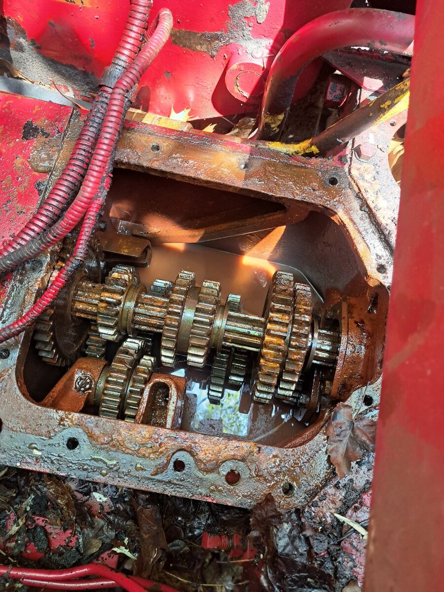

brian falcone Posted May 21 Author Share Posted May 21 Was a long boring winter but back to the td6. Removed clutch cover and pulled the rats nest out. Lubed everything and the dam thing released ! On to the frozen shift lever. Removed cover and found this..... cleaned shift mechanism and replaced worn parts with pieces from the parts machine. Freed tranny gears and everything slides like it should. Tomorrow I'll drain it and flush it then reassemble. Next will be steering clutches . 3 Quote Link to comment Share on other sites More sharing options...

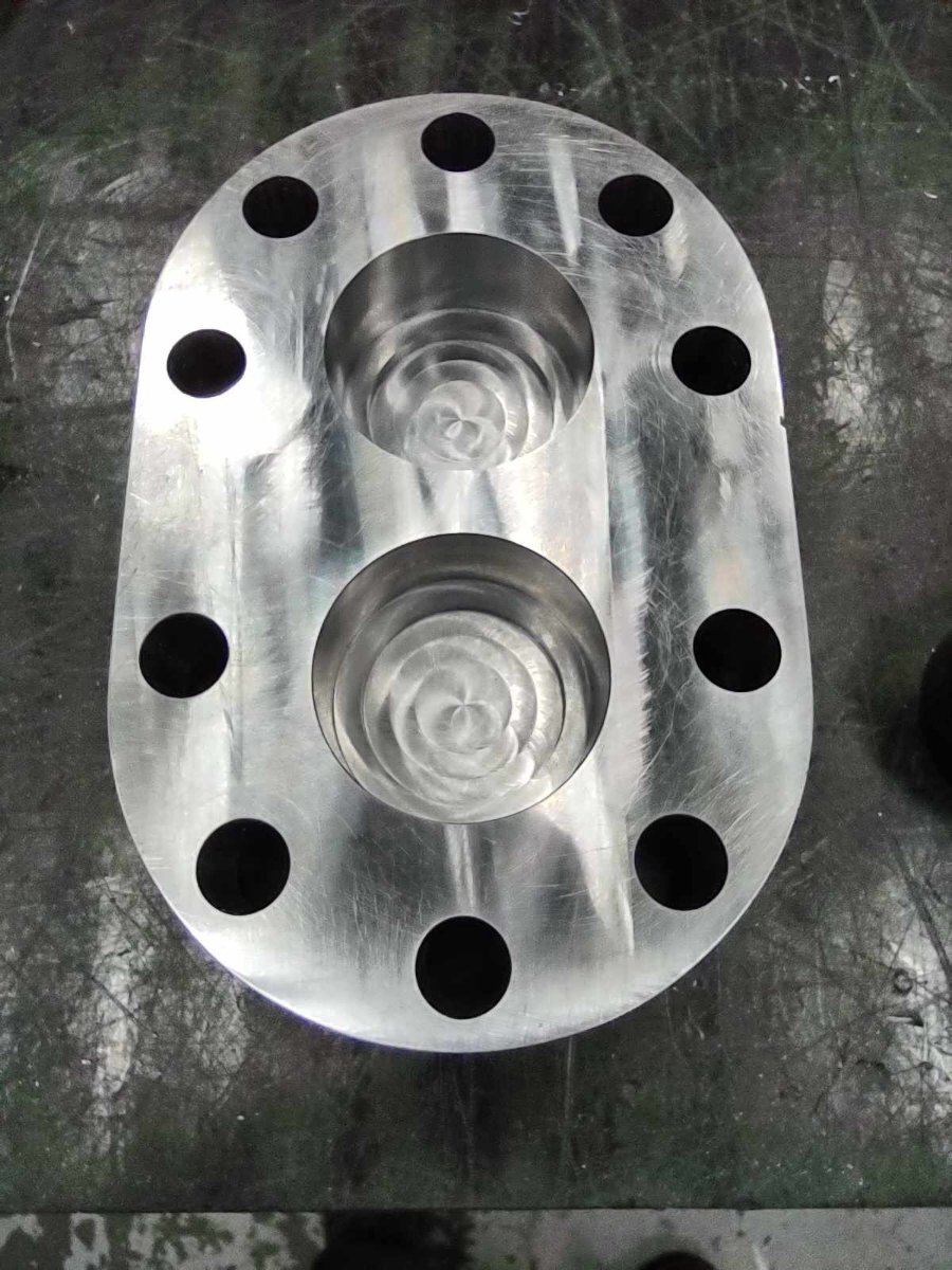

brian falcone Posted September 12 Author Share Posted September 12 Update on The td6 .... The hyd. Pump cover was repaired last week and still failed..... So my brother in law made a new cover. Bearings should be in next week ! 4 Quote Link to comment Share on other sites More sharing options...
Rawleigh99 Posted September 13 Share Posted September 13 Ha, now that is cool! You have definitely left your mark! 1 Quote Link to comment Share on other sites More sharing options...
