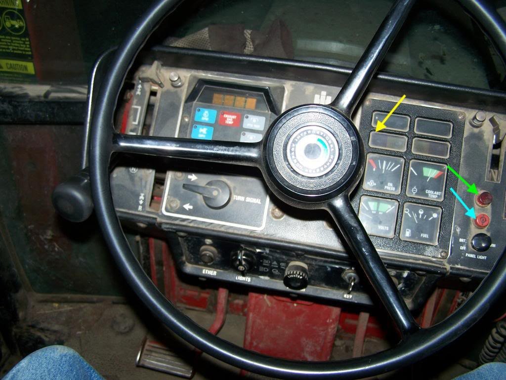

maurer Posted April 7, 2022 Share Posted April 7, 2022 What is the red light on the dash for? What makes it stay on? Temp, pressure, or what? Quote Link to comment Share on other sites More sharing options...
FarmerFixEmUp Posted April 7, 2022 Share Posted April 7, 2022 Does it have the digital data center? Maybe EGT, or could be water level or brake wear indicator. Quote Link to comment Share on other sites More sharing options...

IHC5488 Posted April 7, 2022 Share Posted April 7, 2022 Are you referring to the red light in the dash that looks the same as the red light for the air conditioner? @FarmallFan Quote Link to comment Share on other sites More sharing options...

FarmallFan Posted April 7, 2022 Share Posted April 7, 2022 There are four possible red lights. The yellow arrow in my picture is pointing to a light that is red and comes on when you push the foot-n-inch pedal down.It should go out when the engine is running and you do not have the foot-n-inch pedal depressed. The green arrow is pointing to the EGT light and the blue arrow is pointing the the transmission oil temperature light. If the red light is in the same area as the yellow arrow and has waves in the picture, it's the coolant level light. 1 Quote Link to comment Share on other sites More sharing options...
maurer Posted April 8, 2022 Author Share Posted April 8, 2022 the one with the yellow arrow Quote Link to comment Share on other sites More sharing options...
ksfarmdude Posted April 8, 2022 Share Posted April 8, 2022 That is the low coolant light by the yellow arrow if I'm not mistaken My 1086 would come on and off occasioanally also I changed out the sensor once and it didn't help it woul stll glow after that I'd smack the dash and it would go out figured it had some kind of ground problem after that I just kept an eye on the coolant level and ignored it Quote Link to comment Share on other sites More sharing options...
1480x3 Posted April 9, 2022 Share Posted April 9, 2022 7 hours ago, maurer said: the one with the yellow arrow Like Farmall Fan said, the yellow arrow red light is the equal to the trans pressure light on a gear drive. Quote Link to comment Share on other sites More sharing options...
snoshoe Posted April 9, 2022 Share Posted April 9, 2022 Unless my memory is totally twisted again that light is controlled by a flow sensor behind foot and inch valve. So no flow no light. Possible exception. Self test when key first turned on. Not positive on that. Constant illumination with no oil flowing through foot and inch would indicate faulty sensor or grounded wire to sensor. Again possible problem in self test module if present, but unlikely. Quote Link to comment Share on other sites More sharing options...
