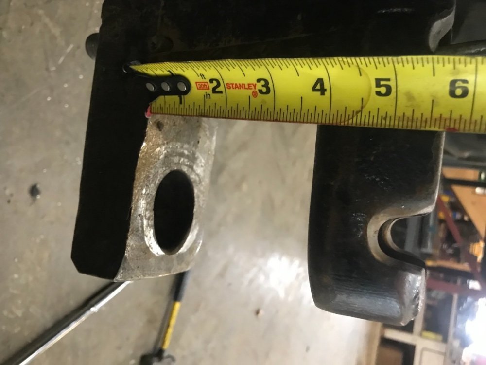

IHC5488 Posted April 2, 2022 Author Share Posted April 2, 2022 20 hours ago, ihrondiesel said: You can buy one from a CaseIH dealer that fits a boxcar Magnum, I use them on my 54’s Do you have any pictures or part numbers? Quote Link to comment Share on other sites More sharing options...
IHC5488 Posted April 2, 2022 Author Share Posted April 2, 2022 8 hours ago, Red Collector said: Have you tried any of the big salvage yards? I looked at All States Ag Parts. Haven't looked since. Google showed some businesses that may have them. My local welding shop can make one as well ....I was just wondering about how big to make the spacing if the tongue or clevis is 2¾" thick...3½" maybe??? Quote Link to comment Share on other sites More sharing options...
ihrondiesel Posted April 3, 2022 Share Posted April 3, 2022 14 hours ago, IHC5488 said: Do you have any pictures or part numbers? I’ll try to get a picture this afternoon. I know it’s a Drop-Pin branded hitch that I got from the dealer. Quote Link to comment Share on other sites More sharing options...
ihrondiesel Posted April 3, 2022 Share Posted April 3, 2022 23 hours ago, IHC5488 said: Do you have any pictures or part numbers? 1 Quote Link to comment Share on other sites More sharing options...
midnightman Posted April 4, 2022 Share Posted April 4, 2022 built one like this for my 5088 and one for my brother’s 1486. Never swing the drawbar so didn’t really need the roller. Now there’s enough room to hook up the 540 pto shaft on the round baler Quote Link to comment Share on other sites More sharing options...
