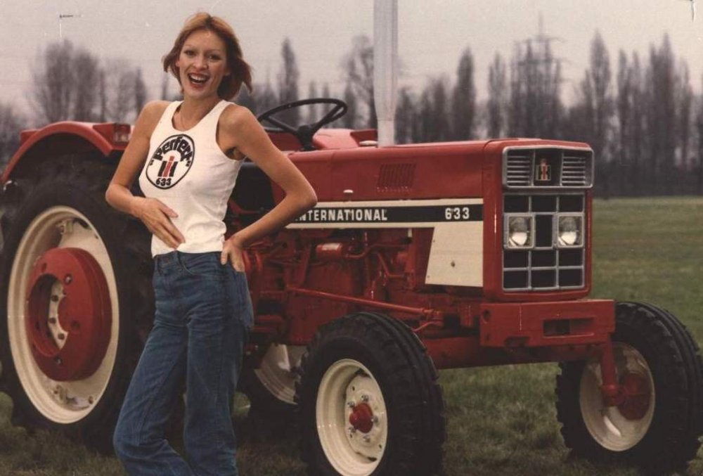

7and8and1456 Posted March 31, 2022 Share Posted March 31, 2022 Tractor look like this one ? Quote Link to comment Share on other sites More sharing options...

td9inidaho Posted April 1, 2022 Share Posted April 1, 2022 23 hours ago, 7and8and1456 said: Tractor look like this one ? Where is the tractor you speak of ???? 😂😂😂😂 1 2 Quote Link to comment Share on other sites More sharing options...
Dirt_Floor_Poor Posted April 1, 2022 Share Posted April 1, 2022 1 hour ago, td9inidaho said: Where is the tractor you speak of ???? 😂😂😂😂 I don’t know, but it must be a little bit chilly wherever it is. 1 1 Quote Link to comment Share on other sites More sharing options...
