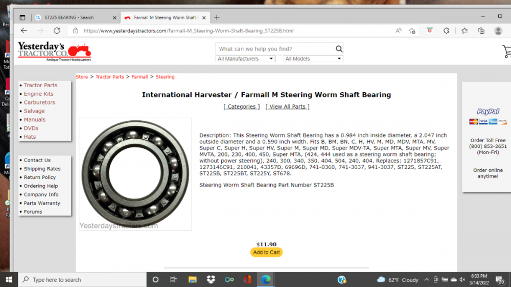

mmi Posted March 15, 2022 Author Share Posted March 15, 2022 Thats why I try to only buy USA or OEM in the box So even thought they are cheap china every one of these retailers is providing the "Wrong" part? https://www.steinertractor.com/IHS2945-Ball-Bearing?gclid=EAIaIQobChMIiYqGlMjI9gIVGXeGCh2zSAj_EAQYASABEgItdvD_BwE https://www.ebay.com/itm/402058592444 https://www.yesterdaystractors.com/Farmall-300_Steering-Worm-Shaft-Bearing_ST225B.html https://www.ebay.com/p/28010899947 note Bob is showing a useless but fixable sealed bearing,hopefully that doenst ship or comes with note ! https://www.ebay.com/itm/303510425526?chn=ps&norover=1&mkevt=1&mkrid=711-117182-37290-0&mkcid=2&itemid=303510425526&targetid=1263104806246&device=c&mktype=pla&googleloc=9059194&poi=&campaignid=16190447015&mkgroupid=128435277530&rlsatarget=aud-1297930287298:pla-1263104806246&abcId=9300820&merchantid=6477864&gclid=EAIaIQobChMIyfqn6cvI9gIVGuXICh0tCwabEAQYASABEgJgnPD_BwE https://www.stevenstractor.com/home/st225b-ball-bearing.html this one is interesting if correct..??? http://www.tractoropolis.com/find-by-type/water-pump-kits-parts/ihc-water-pump-kits-parts/bearing-p-5488 1 Quote Link to comment Share on other sites More sharing options...
hillman Posted March 15, 2022 Share Posted March 15, 2022 7 hours ago, mmi said: Theres the rub if a st225 was speced and lasted 50 years and was used by 50 different mfg and is still subbed from those mfg to the current st225 version why is fiat $110 more +- Adults at MI generally calculate OEm in Fait is marking up parts in the insanity range and if you don't like it too bad IMHO. PTO housing o-ring for Super M t/a is $33 USD . That is 10 times more than a comparable o-ring from a bearing retailer. I doubt they sell a lot of some of these parts so they inflate the price to cover carrying them There is and was never a little bearing like that st678 made that is worth $166. The days of IH making their own bearings was a long time ago and the retailers can source bearing exactly the same for a fraction of the stupid price. apples to apples- spec to spec Fiat is out to lunch Quote Link to comment Share on other sites More sharing options...
