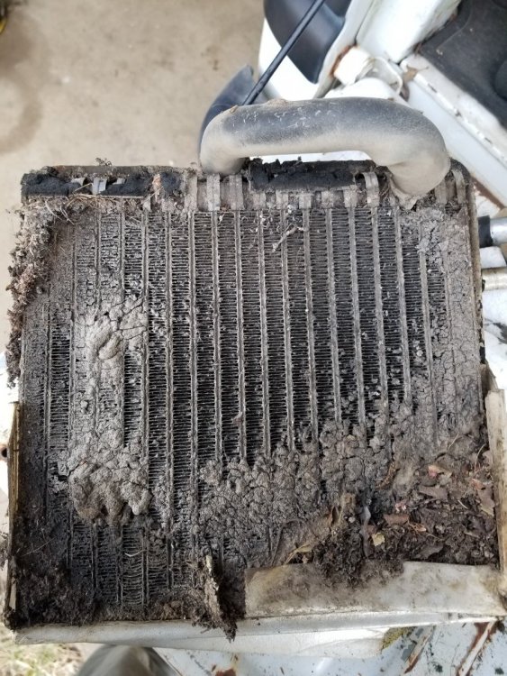

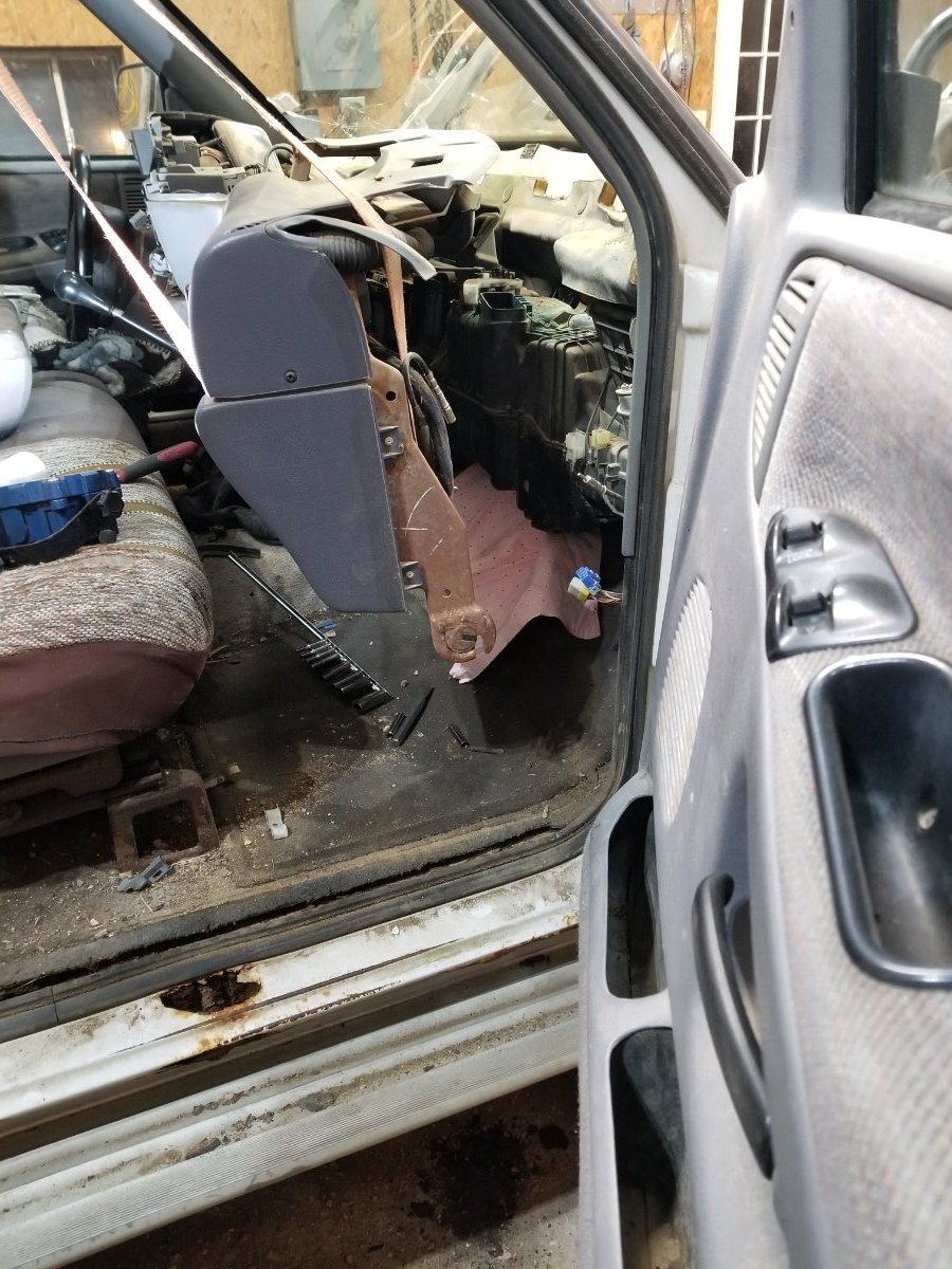

Missouri Mule Posted March 4, 2022 Share Posted March 4, 2022 Well. As some of you may or may not know my mother passed away in December. I have been busy all winter trying to go through her belongings and work towards selling her place. In my spare time I feed cows. In my other remaining time I have been working on my latest little project. I like binder tractors and 5.9 cummins trucks. So I bought me a 97 12 valve dodge with a 5 speed. 180k. Been around this truck since it was a couple years old. My now BIL and I used to "borrow" this truck from his dad in high school while he was working out of town. we put most of them miles on it driving around aimlessly. Anyway I suppose it keeps me busy and keeps my mind off of other things so I bought it. Needs alot of work. Head gasket, heater core, brakes, engine front cover gasket, balancer, dash, radio, just to name a few things. When I'm all done I'll still have a crusty old dodge but I like them. Plans are to jerk the bed off and install flat bed. Paint the cab forward and fix rusty rockers and cab corners. I wanted a decent diesel truck to pull trailers around the farms that I can leave my nicer diesel in the shed. I keep denting or scratching up my better truck and sure cant afford a new one. My smooth looking helper posing for a picture. He could fit back in behind that dash to help me get that wretched heater box out. Anyway it's nothing special to most probably but I thought I'd share where I've been lately. 10 1 Quote Link to comment Share on other sites More sharing options...

hardtail Posted March 4, 2022 Share Posted March 4, 2022 Is that your dirt daubers at work ? Quote Link to comment Share on other sites More sharing options...
acem Posted March 4, 2022 Share Posted March 4, 2022 You need a dash pad, probably the most unreliable part on those trucks. Check the head for cracks if it got hot. Thx-Ace Quote Link to comment Share on other sites More sharing options...
Missouri Mule Posted March 4, 2022 Author Share Posted March 4, 2022 27 minutes ago, hardtail said: Is that your dirt daubers at work ? Not sure what it was. I'm just glad I went the extra step to remove the whole heater box so I could change my evaporator. It was quite a bit of extra work to gain access. Glad I did. 1 Quote Link to comment Share on other sites More sharing options...
Missouri Mule Posted March 4, 2022 Author Share Posted March 4, 2022 2 minutes ago, acem said: You need a dash pad, probably the most unreliable part on those trucks. Check the head for cracks if it got hot. Thx-Ace Yes and yes. I bought a whole new dash pad from LMC. It actually fit very nice. It's all installed. Worst problem is the lower dash is just as brittle as the top. So I broke a couple places trying to roll the dash back in to get screws started. Theres no physical way to push anywhere on the thing without cracking plastic somewhere around the cluster or radio. I'm not quite ready to swap the whole dash out although I was probably only 30 minutes worth of work from being there. My head was cracked. I paid to have it magnafluxed. Good thing because this truck ran perfect. It had a very small coolant leak externally below thermostat housing. Gasket showed where it failed. It has been like this 15 years at least. They just topped off the coolant everyday. So it wasnt leaking much. Just a little trickle after shut off mainly. Quote Link to comment Share on other sites More sharing options...

Diesel Doctor Posted March 5, 2022 Share Posted March 5, 2022 Those heater cores are a B???? to get at in all trucks. The problem is, will the new one leak? Quality is no more. A big project but well worth it. 1 Quote Link to comment Share on other sites More sharing options...
